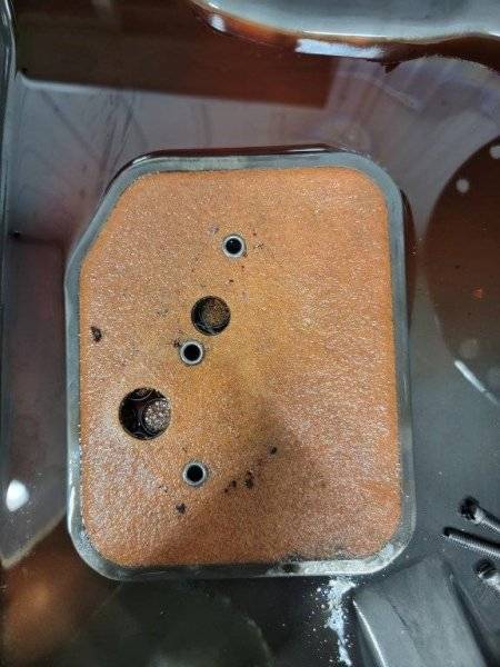

After reading a few more posts here and on other sites, this past weekend i re-adjusted the bands (tightened to 72 inch pounds then backed-out 2.5 turns) and adjusted the shift cable according to an old Chrysler service bulletin. Note we found some clutch material in the bottom of the pan but no metal to speak of. We started it up on the jack stands and 2nd gear shifted fine (figured we nailed it!), so we let it run until warm to get the fluid to the proper level and then shut it off. About 10 minutes later on the restart, 2nd gear started locking-up again.
