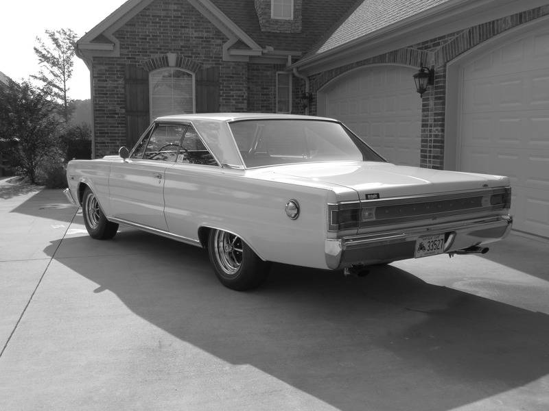

Picked up a 67 GTX a while back.
1. Needs tires
Going with my FAV: "Cooper Cobras"
So; what are the BEST size tires I can put on the car?
Any help is appreciated
