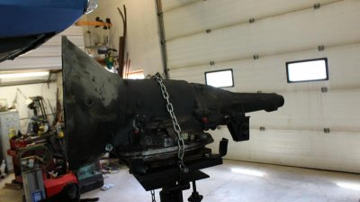

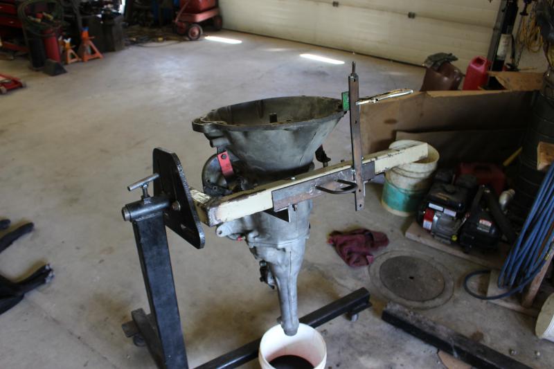

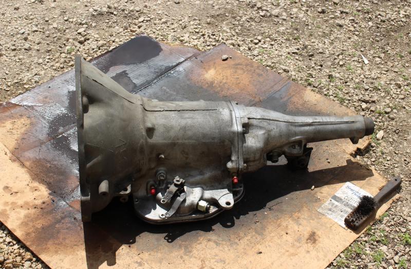

A friend from my congregation who works as a mechanic offered to work with me on rebuilding the Trans. We pulled it out today. It felt good to be a part of the action. I cleaned it up, and we mounted it on his repair stand. He's going to open it up tonight or tomorrow to see the damage. I have a rebuild kit and a shift kit on the way from Rock Auto. One it's re-installed we are looking at bending some nice Dual exhaust.
Thats good to hear. When you said reverse went out I knew you lost the front clutch that applies in 3rd gear and reverse. I was going to ask if you could pull the trans yourself and save some money but this is even better for you. Good luck with the overhaul. Ron
Thanks. He called me today, he dis-assembled it, but every thing looks OK. He's thinking it might be the valve body but not sure. we'll see what happens.
Well it turned out to be a seal. The grip material on the clutch was all worn away except for a very small amount. It hadn't heated up enough to burn either. It's all buttoned up with a nice shift kit installed and back mounted where it belongs. Too wet up here for a road test right now (dirt, scratch that. Mud roads on his farm for about a mile to gravel road and another 2 miles before pavement. Thats ok, it gives us time to finish up the 2.5 inch exhaust with Thrush glass pack mufflers.
