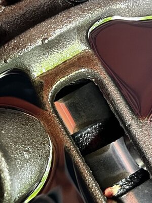

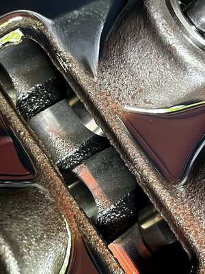

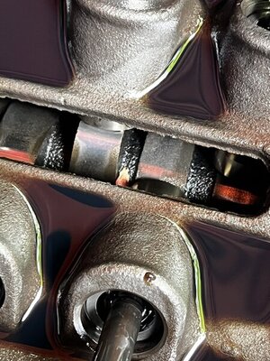

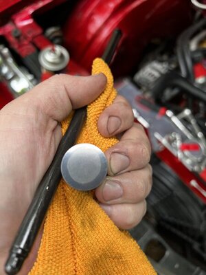

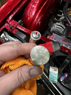

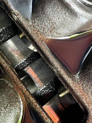

How do these look. I honestly do not know how to read my cam.

The shiny full width of the nose of the lobe means that is has worn flat, and the lifter may or may not rotate. The lobes where the wear is to one side still has taper to it. As far as the lifters go, look at the bottoms at an angle to see the shape of the bottom (or use the edge of a steel rule). It should be convex to promote rotation of the lifter. If it is flat, or concave, it is worn out and ready to start to fail.

I just blew up his photos and I agree that cam and lifter is done for.
The lifters are not worn in. They still have a bit of a tip to them. And every love on the cam looks the same nothing different from lobe to lobe
Just looking at the pictures, I've seen cars with 100K miles that the cam looked better. How many miles on it?

If it were me, I'd take a cupped end push rod and insert it in the lifter and put a 1" travel indicator
on the cupped end and measure the total lift on every lobe. Take out the plugs and turn the engine
with a socket and ratchet. If the lift is the same for all of the lobes, you're probably O.K. Like was
mentioned before, put a steel 6" scale on the bottom of the lifter and see if they are "High" in the
middle. If they all are, the lifters are O.K. If one is bad, they're all bad!
That last picture… the lobe is cupped. It’s toast. Cut open the oil filter and see how much metal you have. When you see that but the lifter isn’t cupped out, too, it usually means that the through hardening process wasn’t completed or the metallurgy is bad. Bad metallurgy will usually cause more than one wiped lobe, though. (nope, optical illusion of lifter on lobe, post 17. Thanks!)

It has got normal wear for a cam with a few 000 miles on it. You could probably keep running it & get a bit more life out of it, but I would get new lifters or have the old ones re-faced.
How do you get lifters refaced???
What planet do they do that on?
I think what you guys are seeing as a cupped lobe is just the outer radius of the lifter body.
Yes, you are correct! I figured it out from a screen I could zoom in on. Oregon Cam Grinders re-faces and hardens lifters, too. Maybe Jones Custom Cams, too? Being that last lifter face pictured has what looks like rough finish and looks like it's about to take itself out, I would probably swap cams. What cam is it, and is it hydraulic or solid? And what valve springs do you have on it? And, what led you to inspect it? Had it started making noise or anything?
