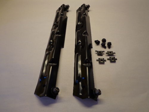

Today, my dad, brother and myself went and picked up a fury for a parts car, There was a fan shroud in the back seat, however, it is wrong for his car, but correct for mine.
I told him I will try and locate a shroud for his car...
Here are demensions of the radiator, its in a 1970 Plymouth Sport Satellite with a small block. Has provisions for a shroud but not the conventional front mount, they are on the sides..
looked around, can't find exactly what I am looking for.. any ideas? or anyone have one?
There isn't one... it looks like a stock radiator, same tank and brackets other then the shroud mounting but no part number on the top
I have another radiator I told him he could use, as it has the brackets that mount on the front like normal, but there is a big dent in the top...
I saw those brackets on ebay... wasn't sure if those were it...
Thanks. That's the info I was looking for...
Anyone have a used shroud and/or brackets for sale ?!? Lol
