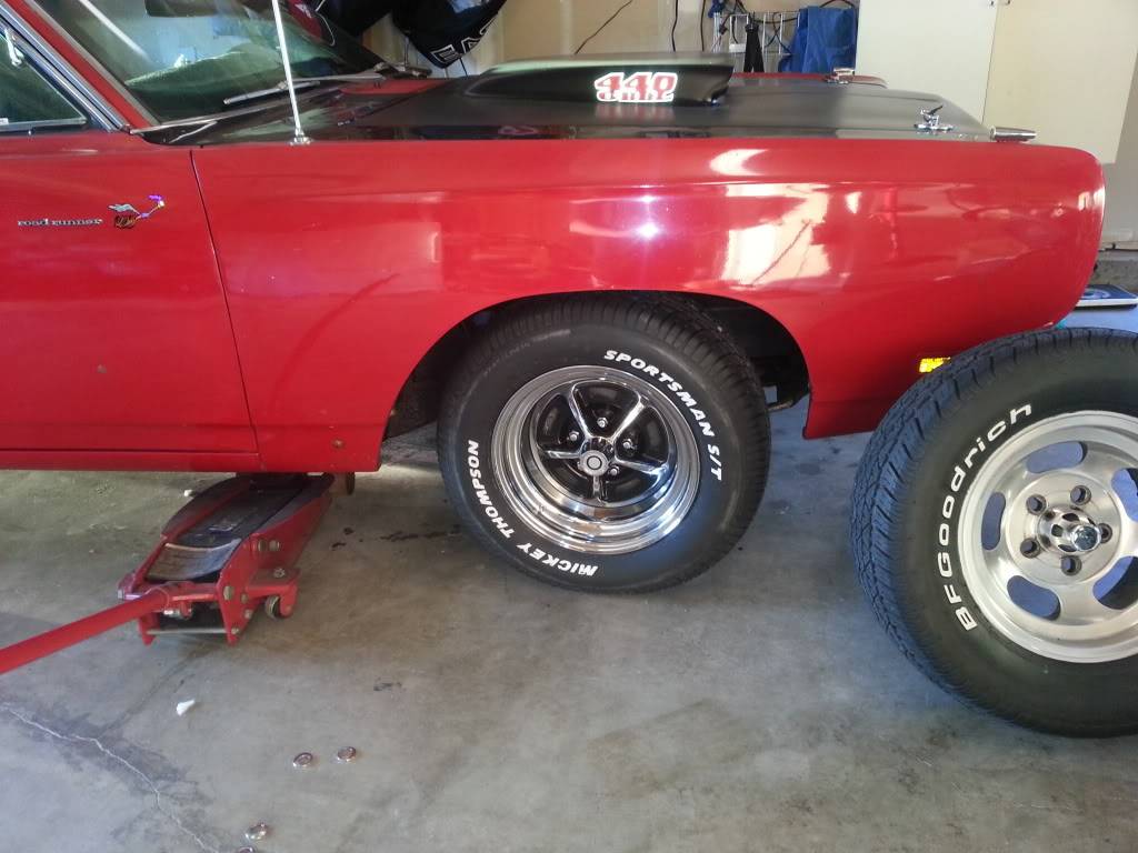

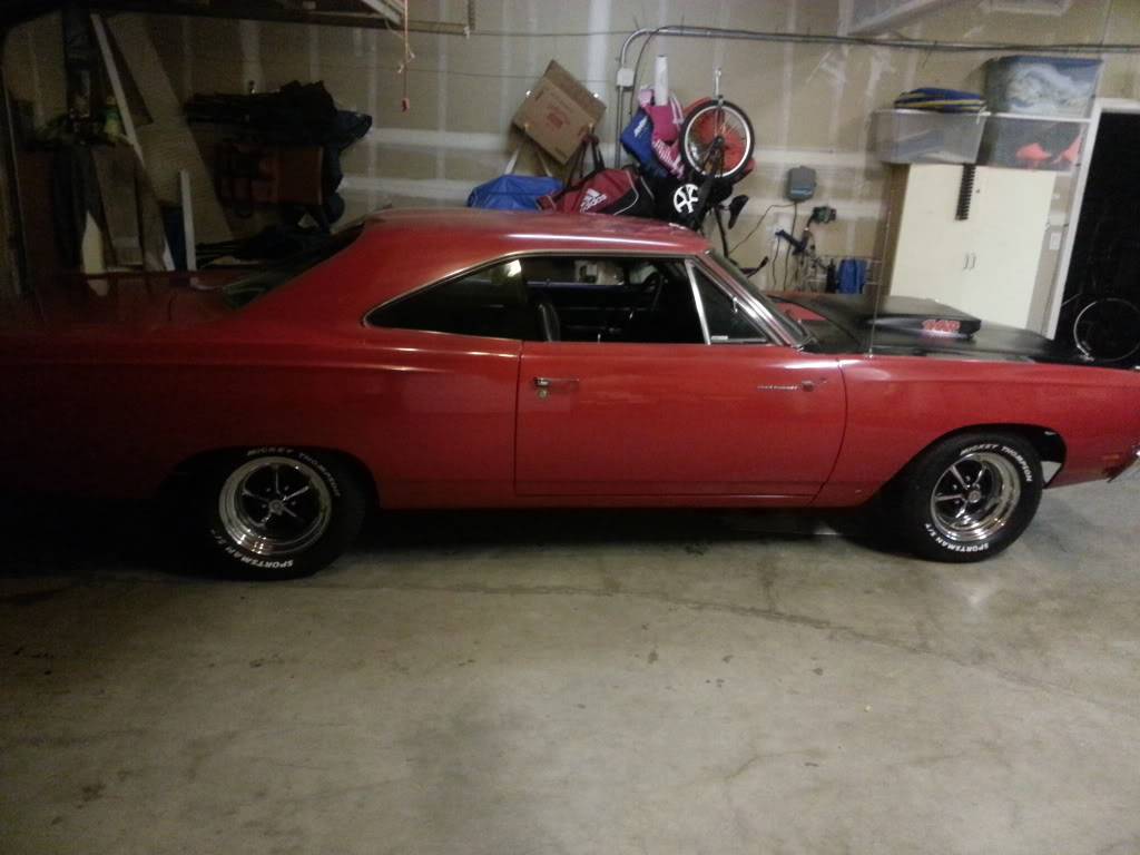

I have 245/60R15 all the way around on my 68. Unfortunately I haven't been able to get it out of the garage as I still need to do the brakes/alignment:
I'll see if I can't get some better images this weekend.

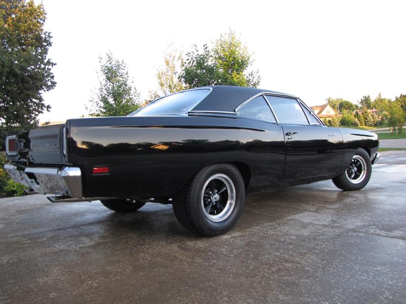

Bead width of relaxed non-mounted tire should not exceed rim width and then hope you have a big enough wheel well. I have 275-60-15 on 15x10's on my 68 Charger RT and no clearance problems. Before that had G50's on it.

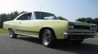

I just picked up a brand new set of 15X7's that I will be swapping on to my '66 Satellite for a little taller ride height. Currently running 14X7's with the BFG Radial T/A's @ 245 60 14's. Planning on the 245 60 15's myself. Should be OK with the 15X7's should it not?...cr8crshr/Tuck
Not a charger but they are magnums

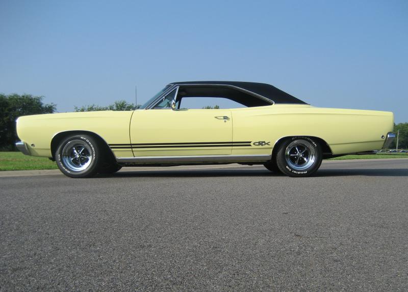

Fronts are 225/60/15's on 7" rims, backs are 275/60/15's on 8"rims

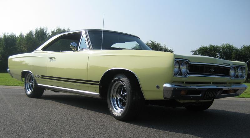

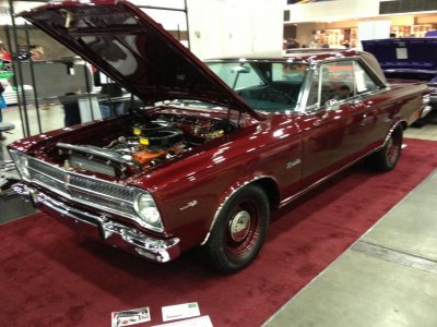

Hi Mike, If I hadn't gone with the steelies & cop car caps, my choice for wheels was either Magnums or Keystones like Sox & Martin ran on almost all their cars. Whichever you choose, they'll look great on your car. Bob
Nice.....your Plymouth sleeps on the red carpet?
@badmopar67, Perfect. Thats the stance im going for. Car looks AMAZING.
@ilm65 That setup looks great. Car looks immaculate, is that a factory color? I do plan on getting those steelies next. Such a good look!

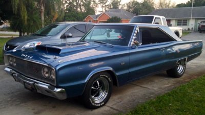

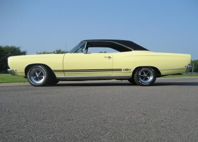

Not Magnum 500's, but here's 15" x 8" rear 275/60/15 with 15" x 7" front with 225/60/15 on my bird.
Thanks for the photo Propwash, looks amazing. I'm definitely going to go with the same sizes on the rear. Will most likely do the same rim size up front, but I was thinking 245s up front.
