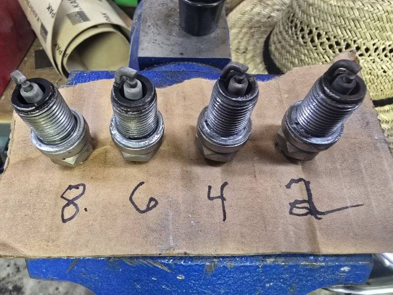

Im thinking im pretty lean buy the way the plugs look. This is after I got home frome a 300 mile round trip. They are lighter in person than the pic. Im kinda surprised by the plugs. I thought an 850 would be overkill for a warmed 440.

Is it as lean as I think it is? I feel like this is a cruise issue. Main jet? How large should the changes be at one time

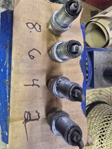

I only pulled the the one bank. I can't image the other side is alot different.
Thanks shane
Lean = No
Rich = Yes
Look at your base , I see black soot
What plugs are those brand and numbers , hard to get a reading on heat range with all that crap over the threads
Is that anti-seize
Plugs should be a '4' heat range in NGK.
