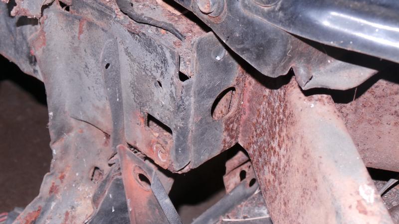

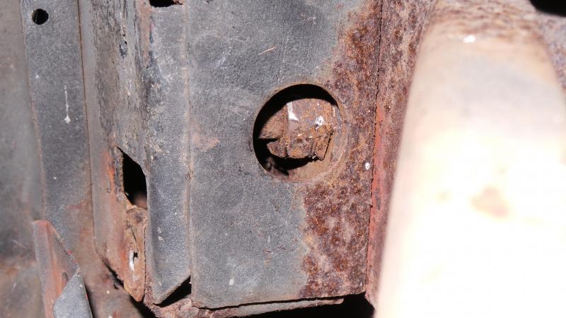

I have had the darnedest time with this bolt! I can get the other side of the bolt head and torque it all day long but the nut, I cant reach. I have swivel sockets and wrenches but nothing can get into the rail through the 1inch hole to hold it in place. This is the last bolt i need to remove to get the front bumper off

Was that an 'anchored' nut that broke loose?
1st thing I would do is hit those threads with some spray. You may be able to get some heat in there (propane bottle torch?) to loosen up the locked threads. As far as holding it...if you cannot get a box end wrench in through the hole, maybe once the threads are broke loose you can wedge a large flat tipped screwdriver in there?
You might just need to drill an access hole large enough to get a socket on from the end.
yep, thats a anchored nut inside the front frame rail...IMO, the best thing to do would be to weld it back in place...which will most likely "unseize" the bolt from it due to the heat from the weld...remove the bolt immediately after welding the nut in place...
The problem is going to be getting enough rust off to get a good spot weld. There isn't much room using that 'dime-sized' hole...okay, maybe it's a quarter.
Grind the head of the bolt off, once the head is gone drive the remaining bolt and nut into the frame rail. Chances are if it's that rusty you won't want to reuse it anyway.
Maybe you can get a file in there to knock some of the rust off so you can get a good spot to weld on.
I like the weld it idea, but you'd probably need a sandblaster.
I like the drill it/cut it and pound it through idea as well.
Have you tried an impact? Sometimes the speed will let it come off, esp if you hold it at an angle, so the nut binds on the frame.
I'd soak it with something better than WD40 and let it set, occasionally pounding on it.
You could also weld a piece of flat metal to the nut, and let that bind on the frame through the hole.
Use a Victor Grinder - A.K.A. Oxy/acetylene torch.
depending on the situation,drilling through the center of the bolt is an option as well.
