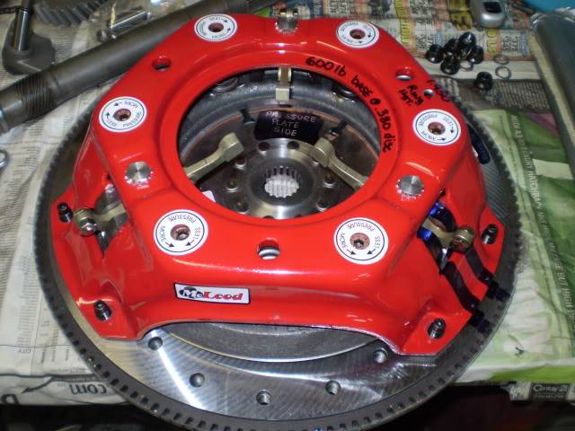

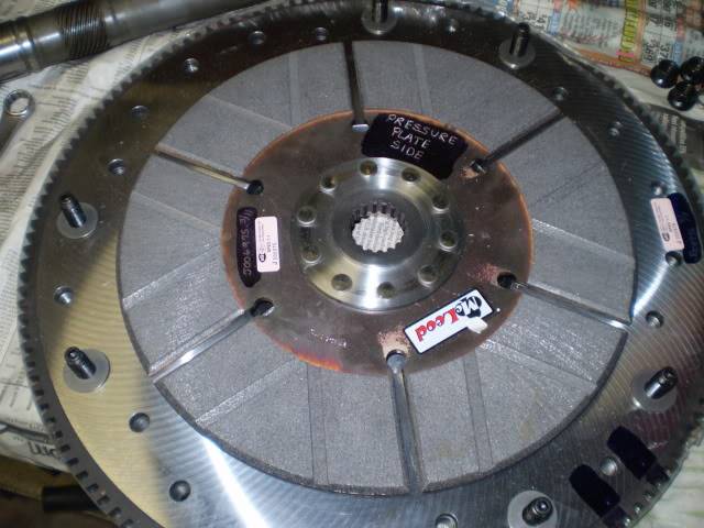

I have a McLeod perf clutch kit with the organic/ceramic disc and a SFI flywheel. Car weighs 3550 with me in it.

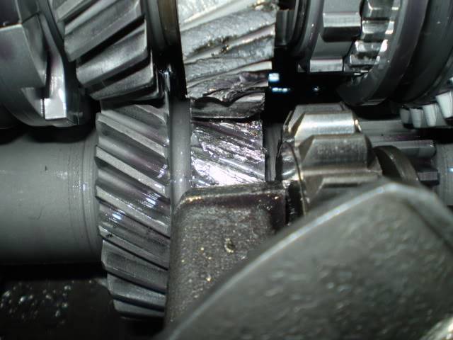

did this with the slipper clutch in, these gears were even cryogenic treated.

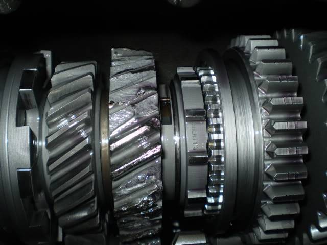

a few other shots of broken parts, got many more i never photographed
Just an observation, but that last picture shows what looks to be a 307 bearing (number on race), and that is for a 23 spline trans. The large 18 spline uses a 308 bearing, and is considerably larger. In your defense, you never stated you had an 18 spline tranny.

Just an observation, but that last picture shows what looks to be a 307 bearing (number on race), and that is for a 23 spline trans. The large 18 spline uses a 308 bearing, and is considerably larger. In your defense, you necer stated you had an 18 spline tranny.
Good catch, its a HEMI box but its in a Dart so i use an A-body extension housing. all the A body extensions had the 307 bearing, even the ones that came in the S/S cars. i actually have an origional one.
in the bearings defense i don't think thats what gave up in that particular trans, she let go in high gear and i think the bearing was a victom of debirs flying around.
and im not trying to take anything away from the hemi box, there a great trans. Just like anything else though they do have limits. i know if the clutch goes back in the Dart it'll be with an aftermarket tranny of some sort, i've spent enough on on these old tranies i could have easily bought a brand new Jerico.

call Hyatt racing and have him build you one. i was able to run this on the street, just had to tighten it up. even took it on over 100 mile round trip drive up to the downriver cruise one day.
