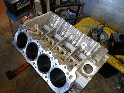

not big deals but I needed answers. I noted the oil feedholes from cam to heads was not open (to sight view) so I could not see how the rockers would oil. Bill explained the rockers do not get oil from the cam bearings on his blocks they have direct feed from the lifter galley and are constant flow, the block has threaded port at top to the rockers with orifices' to limit oil to heads, good feature- now that I know.
the second was a little harder to resolve, the lifter bores are pressed in bronze sleeves-one was pressed in just a little to deep which prevented me from installing cam bearing, I made a tool to pull the guide up about .090 to allow the cam bearing driver to install bearing, too k a while to make the tool, but not a problem. the blocks are awesome, with several additions to the oiling added which can be pluged with screw in plugs to allow the oil system of your choice. the "soft plugs to the water jackets are screw in, so many good features.

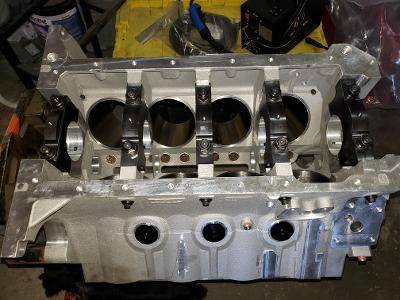

Fortunately for me, when I posted a couple of pictures of what I was told was "my block" by the builder/a dealer for BMP, my eagle eyed forum family pointed out the pics were a Hemi block! That sent me into a frenzy, but it was all taken care of.
They are really fine examples of what can be done and improved on, and I hope to have it turned into a 541 (4.50 bore x 4.25 stroke) beast by October of 2022 or 23 at the latest.

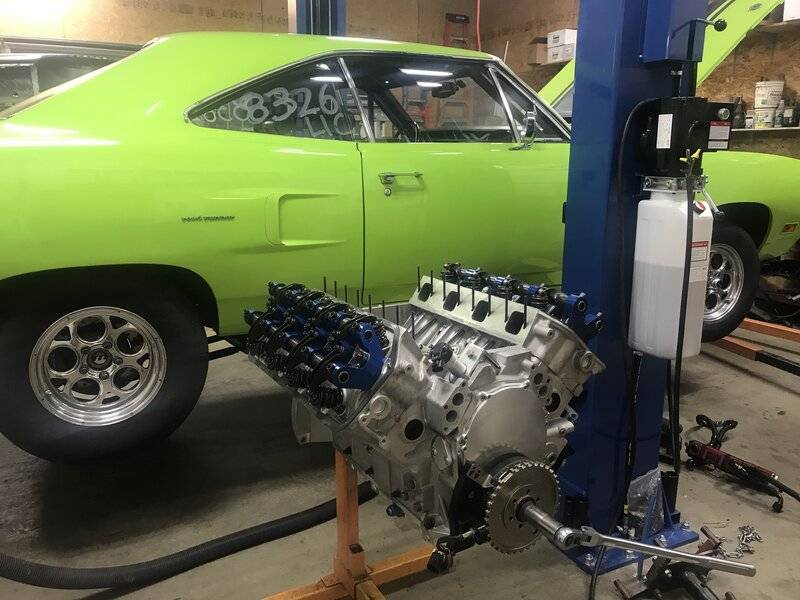

As members here know, lots of posts about my "big plans", but money to do them and time to get them done is limited. Still, moving forward, and now owning my BMP block is a milestone, a "checked off box".
