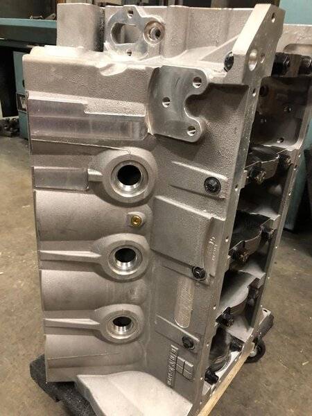

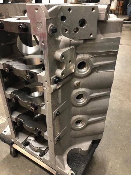

I don't know if you can tell or guess from seeing a picture, but this is supposed to be the new Hemi Gen 2 Bill Mitchell block:
Still looks the same. See the large relieved area above the main web. When I have a chance I will post a pic of an Indy bottom end.
