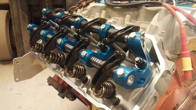

And of course, gotta have a picture

I'd say "prime it and fire it" too...but since it's out in the open, myself I would double-check the valve lash, and that the rocker shaft hold downs, head studs, and rocker adjusters are tight...

If it was sitting for the last 18 years with the Valves adjusted and NOT backed off....and NOT being turned over/rotated over that 18 years ?
I would be at least be checking the V/Spring pressures.....
because,
undoubtedly one or more V/Springs were sitting fully compressed for that 18 years ?
and,
all it takes is one V/Spring to be "not up to snuff'...... and you could experience a serious problem with a Mechanical Roller Cam
