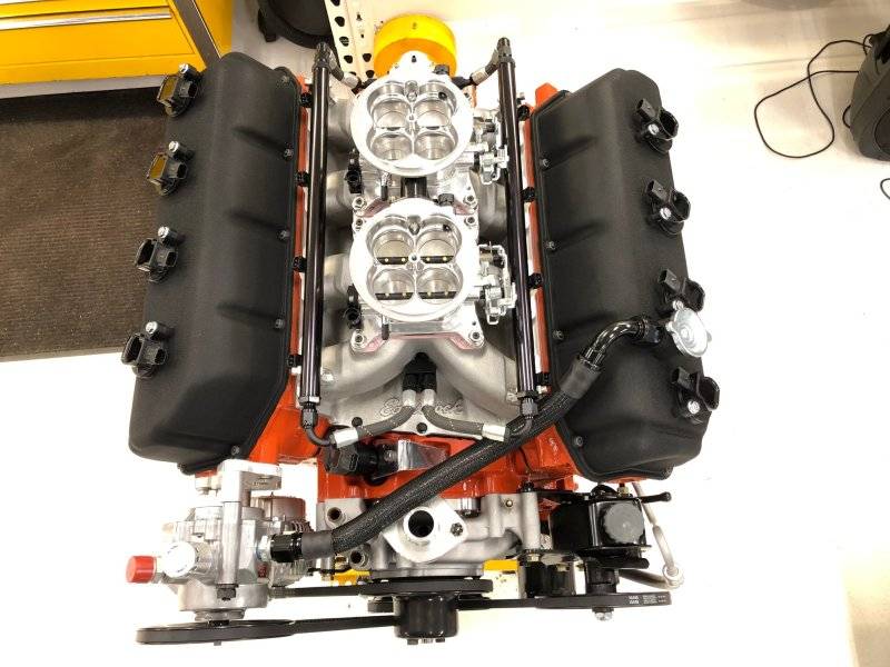

Mine is 438ci, iron block and heads. 12.4-1 262/262 @.050
E85 mainly though has EFI with a composition sensor so if necessary to run on gasoline auto adjusts fueling and removes timing.

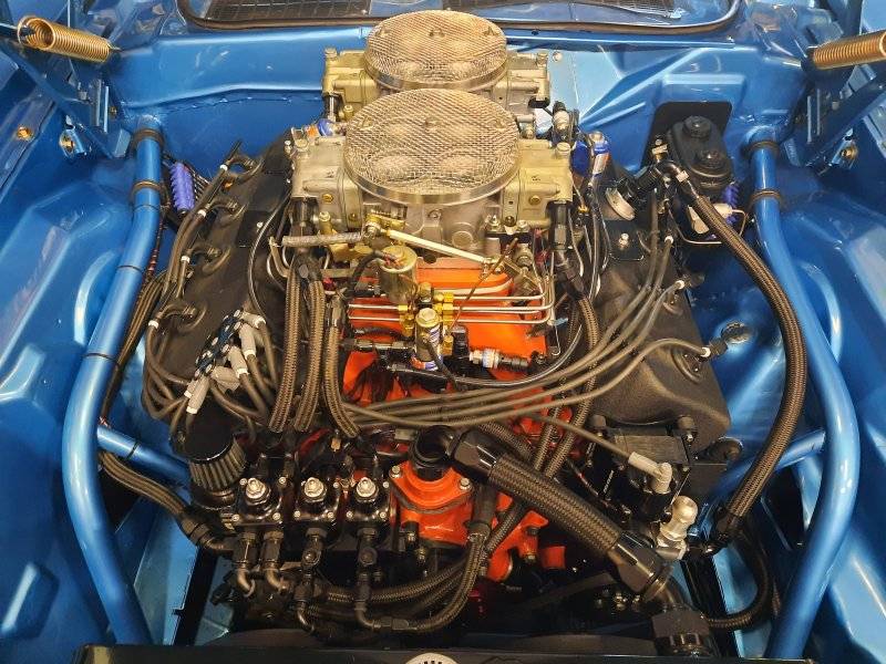

10.5 to 1, 250ish solid flat tappet cam by Porter Racing Heads, MP ported iron heads, MP cross ram w/worked holleys and a 5 speed. Timing -18deg initial, 34 total. Vehicle weight is 4250lbs. Plugs read very good for timing and AFR meter readings good.
