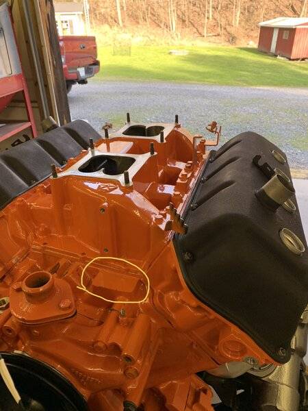

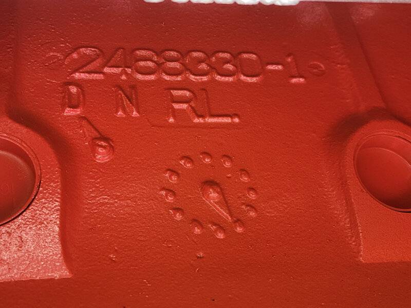

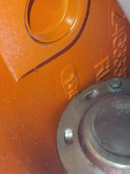

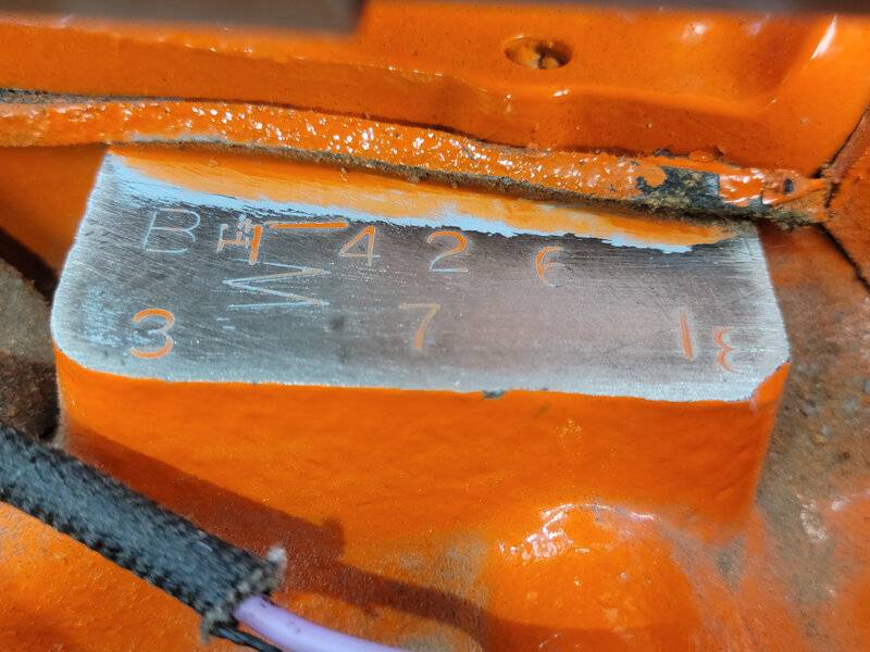

We got a pretty special B-body in at work, a 1966 Coronet Hemi. The fender tag shows it to be a true factory Hemi car and it's claimed to be Govier certified. My general manager claims to have owned the car at one point, found the original block and had it all re-done before selling it years ago. He tends to exaggerate quite a bit. Anyways, I've been doing my own searching over the block and it appears that the casting number is correct. I can't get a look at the year of the casting date, just the month and day, January 18th. I did find this stamping on the block though, I was hoping someone may be able to identify what it means.

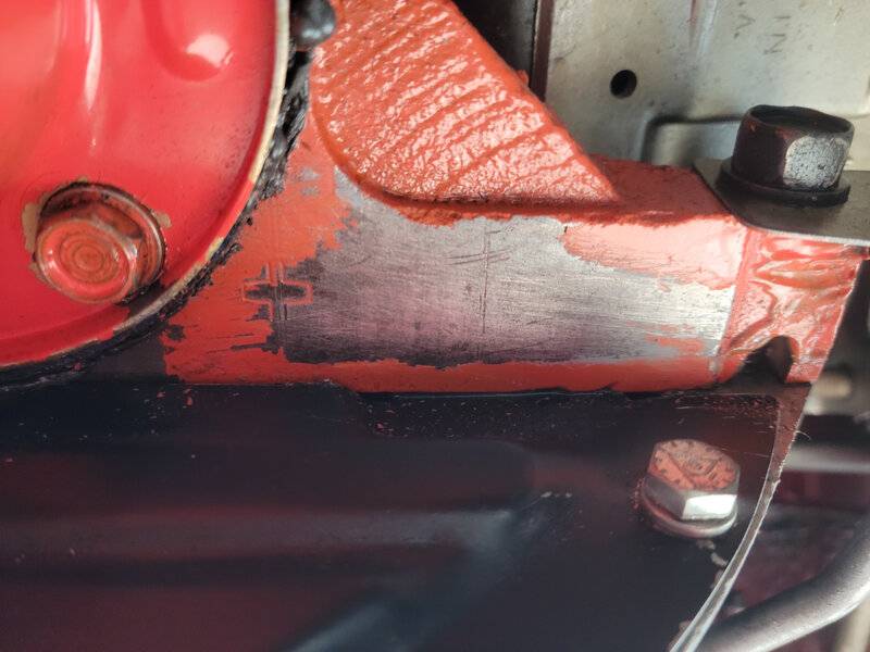

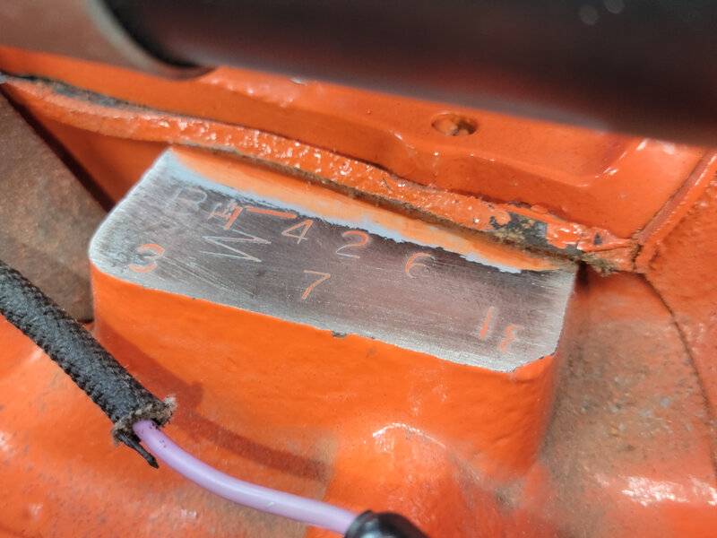

yep they have a front pad for sure same location as 440. drivers side front valley rail next to intake
It was assembled and is stamped for the 66’ model year so there’s a good chance it’s legit. The assemble date needs to be just prior to the assembly date of the car

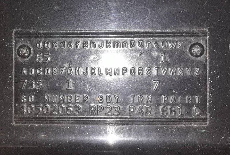

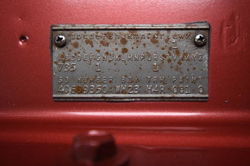

Got a picture of fender tag to see scheduled production date? That would be a check to see if engine was assembled before scheduled production date. The block cast date 1-16? 66? the BH kinda proves its a 66 block.
And a red with red interior car even. Very nice.
The vin isnt by chance WP23H61237256
My Satellite was the SBD of the day before
