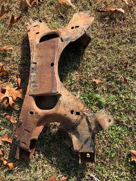

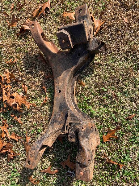

Hello all,
Looking for location on K frame where part number and/or date stamp can be found (pictures attached). Mine is dirty but not rusty, so hoping to find location. Also hoping K frame is for 68 or 69 B body - width is 34 inches between hole centers and front to back hole centers are 13-1/4 or 13-3/8 (hard to tell exactly). Also seem to remember someone telling me steering idler arm attachment holes might have changed sometime in late 60s, so would like to confirm that as well. Thank you.

You have 68 and newer idler arm mount.
66-69 skid plate and sway bar mounting holes.
