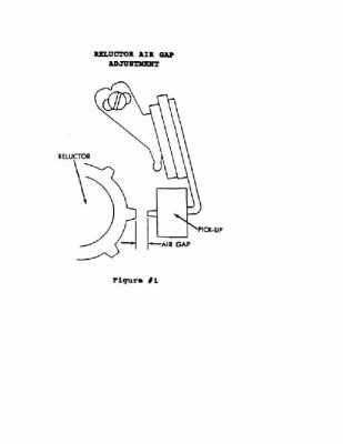

My situation was ignition and I found out by putting the timing light on the coil wire when it wouldn't start. Problem was that it was somewhat intermittent because the pickup coil still provided some signal when hot, just a weak one, so I would get inconsistent spark. Sometimes it would fire up, but most times it wouldn't.
Narrow it down by getting a timing light on it when it is in the situation, if you get consistent spark - its not ignition.
If you don't get spark when it doesn't start and it sounds like the situation I described, you may want to try narrowing the reluctor gap. Just loosen the screw in the distributor holding down the pickup coil and narrow the space getting it as close as possible without touching and snug it down. Make sure it won't hit though.
