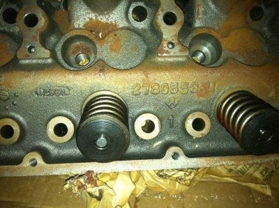

have a chance to purchase a set of Hemi 2780559 heads date code 1970. Question is what is fair price for the head? See picture These are still in the original box and never installed. But seems a little moisture has made it to them

For pricing it seems to me that the available new heads set the bar. The head you show in the pic can be drilled for a second plug, so they are not stock but rather an old DC part I would guess.
