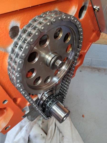

What timing chain set do you have?maybe it requires a Torrington bearing between spricket and thrust plate?
So actually I have found the issue. It seems I had pushed the cam too far back into the block. So now I have it aligned. Waiting for the cup washer to arrive so I can keep it aligned and againsed the thrust plate.

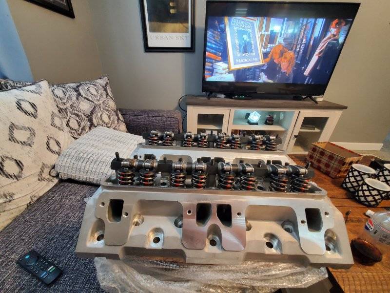

I see you installed adjustable rocker arms; are the adjusters cup or ball? It makes a difference when dialing in the final pushrod length.
Regardless of cup or ball, rotate the each rocker's adjustment screw until the adjuster bottoms out against the underside of the rocker. Then counter-rotate 360° to drop the adjuster down one or two threads from the rocker. This gives wiggle room for any final adjustments when installing the pushrods.
Pick a cylinder, doesn't matter which one but most people default to #1. The cam lobe has to be on the base circle. With the rocker arms cinched down (don't have to be fully torqued), increase the length of the checker pushrod until it won't rotate by rubbing one finger against it. Now its at zero preload. Continued lengthening of the checker rod will only increase lifter preload. Now add your preload to the pushrod length, typically 0.030" - 0.060". During my build I talked to Dave Hughes at Hughes Engines, and Mike Beachel at B3 Racing, and each said that choosing a preload number isn't critical. A tighter preload may be a little noisier at cold idle.
If the pushrod is ball end, you're done. Cup end is a little tricky because you have to subtract the depth of the cup from your total length. I used PRW rockers with cup adjusters (ball end pushrods) so I was done. Using calipers you can try to measure the diameter of the ball.

These are the rockers i bought. so I'm assuming they're very similar to the ones you have.

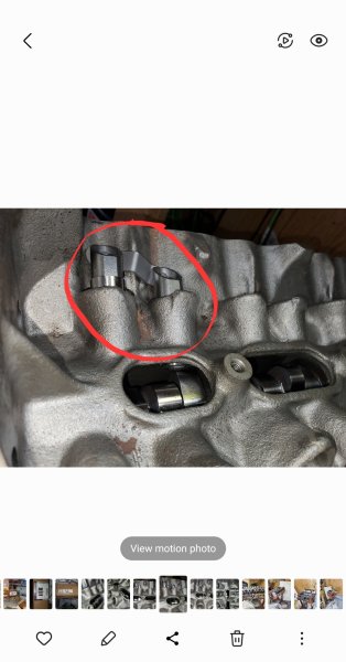

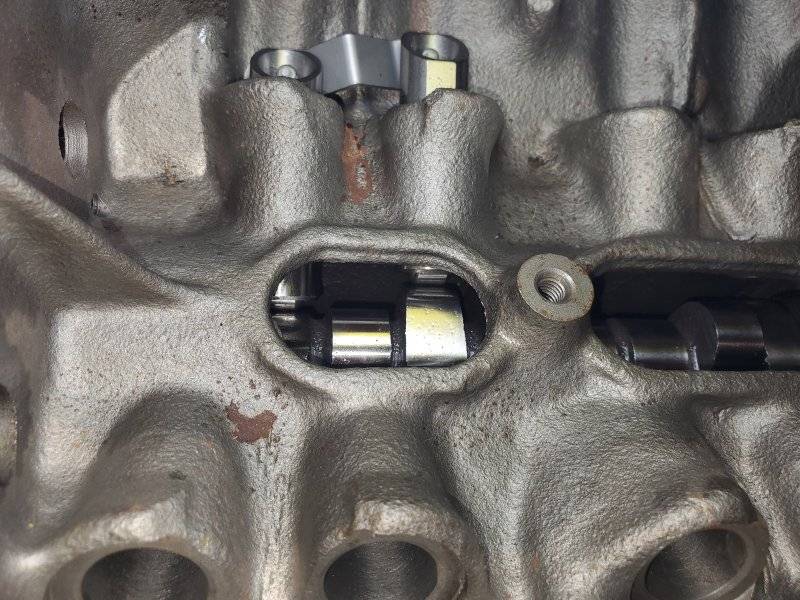

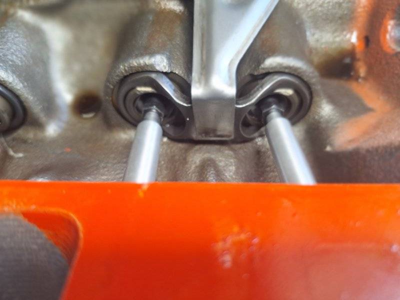

Sure don't like the severely bent guide plate on those lifters...
can you elaborate? im not in front of the heads right now and in the pictures im not seeing anything out of place. but again im a novice and could be overlooking things. which is why i post here asking for tips tricks and advice.

Those look like the rockers that I have. Cup style lifters, ball type pushrod ends. That's good, takes one variable out of the equation.

Are you referring to this. That bar that connects the two lifters? This is how it came out of packaging from the kit. The lifters and cam came as a kit together. Posting below to see if that helps.

The threaded bosses in the lifter valley are for the lifter hold-down (commonly called a 'spider'), which implies that its a roller cam block. I have a Magnum block, which has some differences from an LA block.
In the magnum, the lifters are held down by the 'dog bone', and the dog bone in turn is held down by one of spider arms. I thought the LA roller blocks had the same setup, but I could be mistaken.

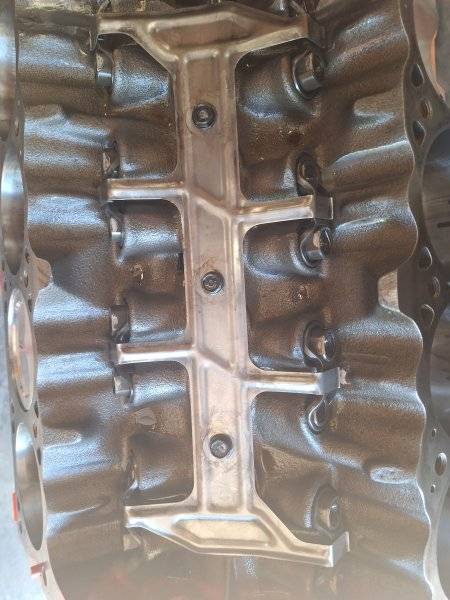

Here's a close up of the spider arm holding down the dog bone, with the checker rod in place.
Bird's eye view of the lifter valley with the spider in place.
yes i have this piece in my parts pile that came with the engine when i first got it. the old lifters came with it to and the dog bone connector is a circle that the lifter rides in connected to a straight piece connected to another circle the other lifter rides in. those lifters sit loose in the dog bone and the spider holds it all in place. the Howards lifters are attached to each other with that v shaped bar. i can still put the spider on as i still have it and its in solid shape. however i was told that with 1.6 rocker ratios the spider may not work and it might be better to not use it.
