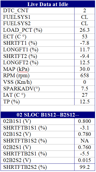

Hey guys,
I mainly am on the forabodiesonly forum but occassionally pop in here. I did a 5.7 conversion on my A-body and am having some running issues.
A brief rundown of what it has:
Fuel system: Tanks Inc, in tank walbro 255lph pump and setup, to a corvette filter/regulator, 6.1 fuel rails with 5.7 injectors. -6AN braided lines.
Has a brand new battery. Hotwire auto full emissions harness (front and rear o2 sensors either side of the cats)
I constantly get 50psi on prime with this pump, but 58psi once the car starts. I thought my fuel pump might have been on the way out when I started having issues so I replaced with another brand new walbro 255lph and it also primes to 50psi and has the exact same running conditions. Issues are hard starting when cold or sat overnight, takes a few goes to get the engine to fire up, when it does fire up it coughs and splutters and stalls, after a few goes it does run and idle fine, it occasionally has a slight rough patch but then might sort itself out. Responds ok to light throttle application, but a decent hit with the throttle and it bogs right down and stalls. I have also replaced the filter/reg with another wix one with no change. The injectors are the stock 5.7's that came with the engine and had them cleaned, re-kitted and flow tested. Yet the car still runs like this.
Brand new battery, brand new pump, brand new filter/reg, new gas, rebuilt injectors, checked pcv valve, cleaned throttle body. It's starting to get beyond me and I don't know what to look for. No engine codes are up other than:
P0480 - Fan 1 Circuit Control
U0155 - Lost Communication with Instrument Panel Cluster (IPC) Control Module
These I believe would show on any car though as it can't see the factory dash or the factory fan setup. These have always been highlighted on the car whenever I plug the scanner in to the OBD2 port and cannot be cleared obviously.
An example of what it does till it get's running:
https://www.youtube.com/watch?v=e0bVj1DpofM&feature=youtu.be
I have live data but I can't make much sense of it.
If anyone has any suggestions or similar issues I'd love to know what you think.
