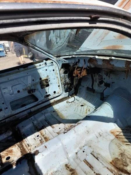

Do you need to cut the trans tunnel on a 71 B Satellite to fit a HEMI 6.4 / TKX 5 speed ,I fitted a magnum 6060 to my Challenger & know there was quite a bit of modification needed to the trans tunnel TIA
If using the TKO you will need to cut. The TKX is a slimmed down case and supposedly no cutting is needed. I just watched a Youtube video of a guy mocking up one in a B-Body and it looked like it had lots of room. Let Me see if I can find it for you. It is called The Familys Garage.
