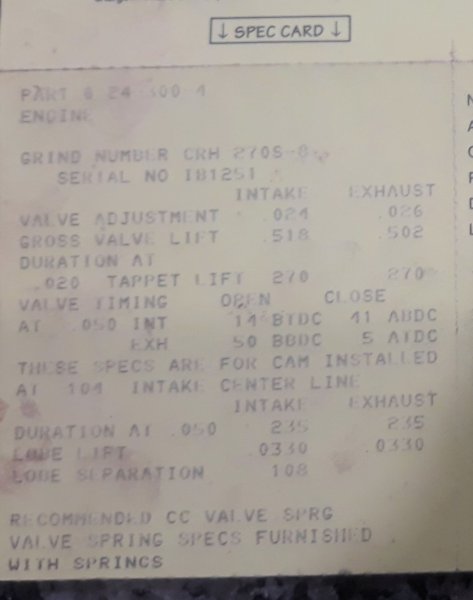

My cam card just for reference
But mine is solid lifters
But I cant imagine this specs is for a hot engine
Are your heads steel or aluminum? Makes a big difference on aluminum head big block Chevies so it might on a Hemis too?
From what I know and have seen over the years camshaft manufacturers always specify HOT lash settings.
The lash obviously needs to be correct when the engine is hot.
Like Rick said if you want to set them cold depending on head material etc you reduce the gap used.
