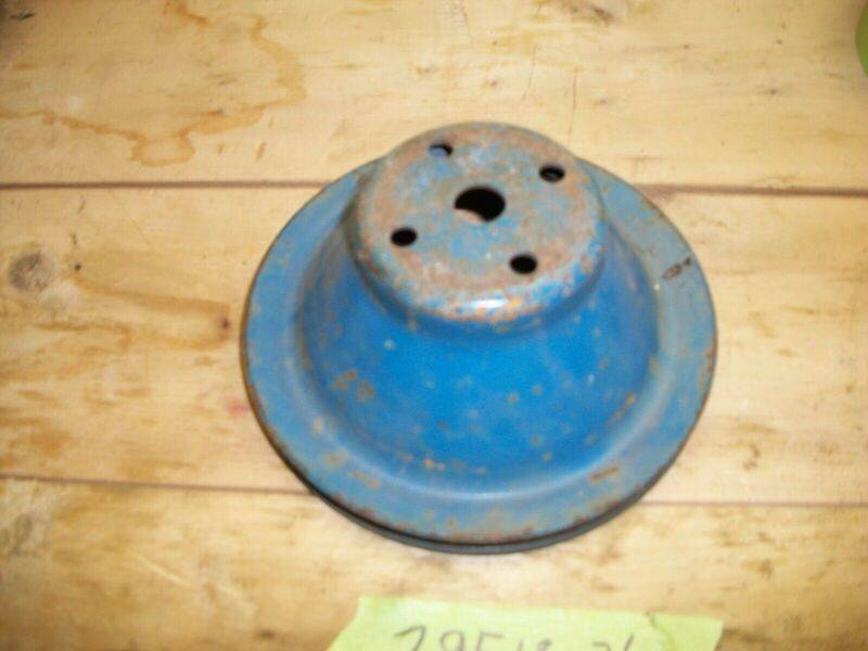

Hemi water pump pulley???
Around '69-'70 they started using the smaller pulley on A/C cars to speed up the fan for better cooling. The part number is correct for a SB of that era.

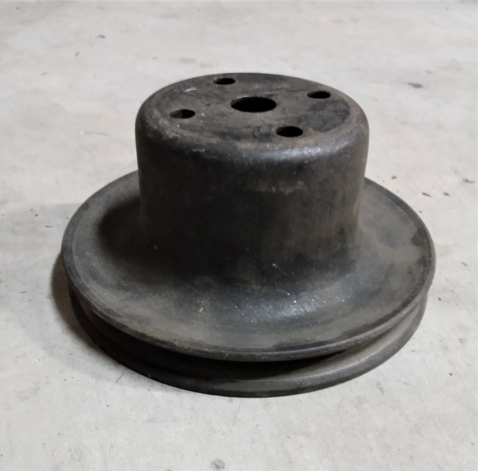

I looked through the ad and never saw a part number in the description.. Then I just saw it up in the manufacturers part number but it looks nothing like this one w/ the same part # that why I was thinking listed wrong and another application... https://www.ebay.com/itm/MOPAR-2951836-WATER-PUMP-PULLEY-SINGLE-GROOVE/154090748777
The one auctioned...
The this one has the same part number from another auction...
Measured one my 66 or 68 Hemi WP pulleys 6 7/8". Think they were smaller in 70/71 but not sure.

That 2946716 I don't a 1966 PN. I have 2-66 pulley (sheave) and a 68 I know these the history of them. They came off 3 engines Ive had all 6 7/8". I'm not saying your wrong about the pulley 2946716 being a Hemi pulley because I don't know, you don't say what year or other info if any.

I put in my first post I wasn't sure about 70/71s. Seen then for sale and they looked different. Still learning. Reading threads on here has been educational.

66 to 68 early Hemi used the normal Big Block Water pump pulley. The Crankshaft pulley was hemi specific to compensate for the thicker damper. In late 68 up they used a smaller pulley diameter for the water pump, and it has a shorter height then the look a like small block shown. Small blocks had a few different pulleys depending on water pump type.
The 68 late crankshaft pulley changed to again. Along with moving from the TRW PS pump to the Federal. This drove a change to the alternator going to a dual pulley for alignment.
69 up Hemi WP pulley will not work on a normal big block with thin damper, without shimming. The height is not the same.
On my dads 440/505, we used the factory pulleys off his numbers matching 70’ Challenger RT, it has the smallest water pump pulley I’ve ever seen.
