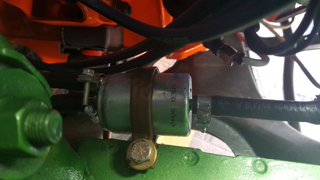

I believe this may be the problem. Smaller napa filter ?
If this filter is installed prior to your mechanical pump I will practically guarantee this is the source of your issue.

Also, yes, you should have a 3/8" line from tank to carb with vapor separator fuel filter (return line).
I'm sorry I didn't look closer when you sent this pic to me, but that definitely appears to be installed between the tank and the mechanical fuel pump, a definite no-no. The fuel filter should absolutely be between the fuel pump and the carburetors!
