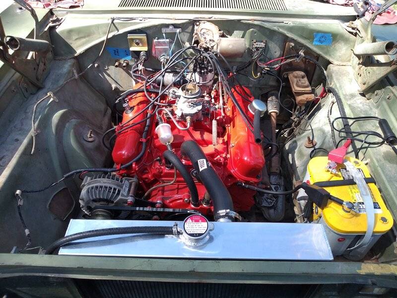

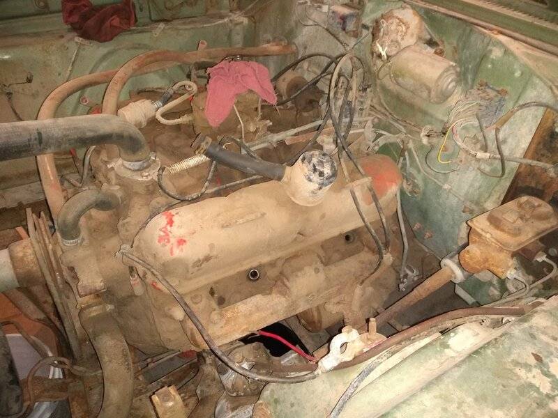

Finally got the 1968 Plymouth Satellite Sport fired up last weekend. Been setting in a field for about 30yrs.
Original 318 was junk. Parked with a blown head gasket and filled with water. Found the valves were rusted off and laying on the pistons.
Swapped in a donor '84 D150 318 block and heads. Crate motor and looked like new inside! Salvaged all the original 318 stuff I could like intake manifold, valve covers, carb and exhaust manifolds. Upgraded to electronic ignition and newer charging.
