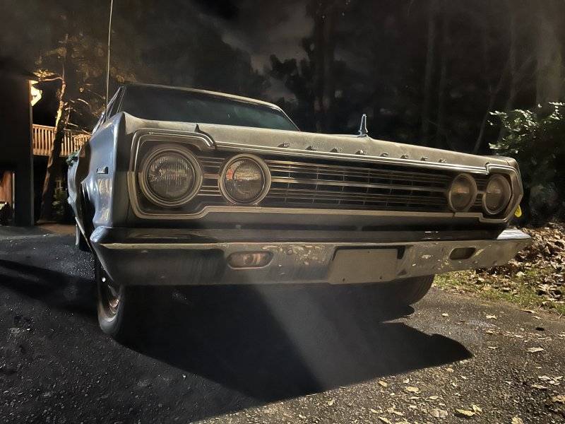

Hey folks, joined here to get advice on my new Belvedere, i might just be the youngest member on here, buying my first classic at 16 years old. The Belvedere has been sitting about 3 years, and I just got it running today. I bought it from the original owner for $2700. It’s a 318, factory a/c car. 90k original miles- not rolled over. I’ll list my issues and requested tips below.
I could use belt sizes, and maybe a diagram I don’t have the owners manual. All the belts are extremely loose and dry rotted.
3 wheels are completely seized, and the brake pedal is rock solid, no movement.
The radiator is not building pressure, I can take the cap off with it hot. But I have hot heat in the car, so coolant is flowing through the heater core.
I have no temp gauge or gas gauge, neither have moved at all.

Good evening and welcome to FBBO. That first picture looks like something out of a movie. Very nice shot. And I love your car btw.
How long had it been sitting prior to you getting it running recently? And congratulations on getting it running!
