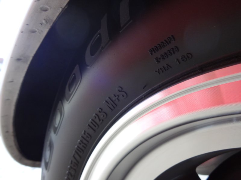

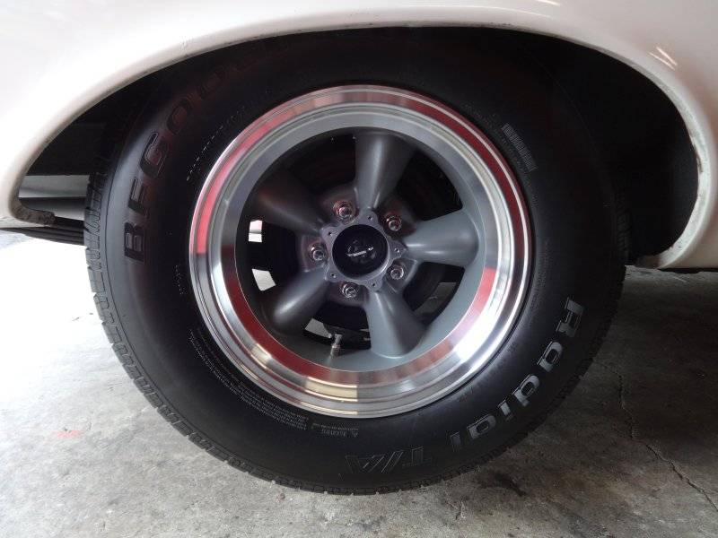

Hey Jay. Thought I'd give you the tire and rim size for my American racings. The rears are 8.0" Tor-Thrust D. The back space is 4.50"
The tires are BFG TA's P235-/70R15. I first tried 8.5's with 3.75 back space. They won't fit with the longer 64' tapered diff. The tires are a bit small (to me) and I will be going up a size next year. My front rims are 4", so I won't bother with the tire size. I think you'll want to go with 6" up front for your car. Hope this is helpful.

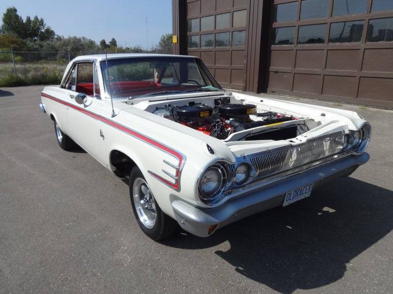

Greetings from Canada!!! :canada:Wait. Your here too! Fantastic car, 64's rule!! My Dodge was built in the US,
but my 64' Sport Fury is Canadian. Your car has the very same interior as it does. Gramps really knew how to
pick out a car. Enjoy it as much as you can!
That car looks awesome! I noticed it has a passenger side mirror, mine only has one on the drivers side.

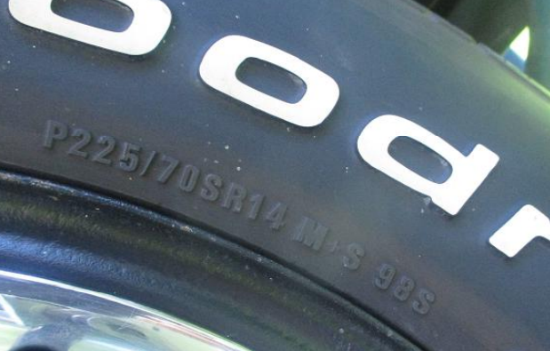

The tires on the car below are 225/70 on 6" rims all the way around. I think the fronts are fine, but
I find the rears too small. The wheel house can hold more tire and rim. I would go 8" for that rim.
I hope this helps a little.

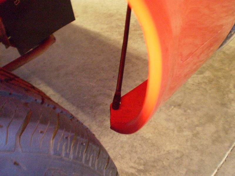

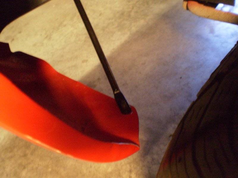

I run 215 R 70's on the front of my '64 Polara, on 15" X 7" rims. When turning the rims and tires through the front fenders, side to side, the tire would snag on the fender at leading edge of the wheel well. This is because the fender rolls in so far at the front. I had to trim the fenders back to the brace rod with a cut off wheel to avoid contact. I had shorter 14" tires on before, and it never did this. so, you need to watch tire height and rim width to avoid this. I use the same tire and rim size on the front of my 1967 R/T, and never had this problem, but the fenders do not roll in as far. I found that 225 R 70 tires would rub on frame rail at full turn.

7" wide rims may have contributed to the problem. They replaced 14" x 5 .5" chrome Magnum 500's that I used to run, so quite a size change. 15" tire is likely taller than the 14" tires that were on it, also. Maybe different offset as well. When I bought these rims, 15 x 7 were all that was available. Like I said, I had no clearance problems with this combo on my R/T, so I gave it no thought. I run the same wheel/tire combo on all 4 corners on the Polara. I have 235 R 70 X 15 on the rear of my R/T.
Maybe 205 R 60's on 6" rims could be the answer. Shorter tire than a 70 series, but would be about same width as 215 R 70
