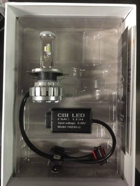

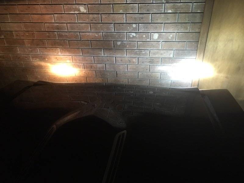

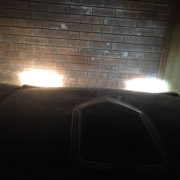

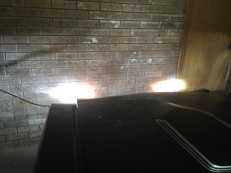

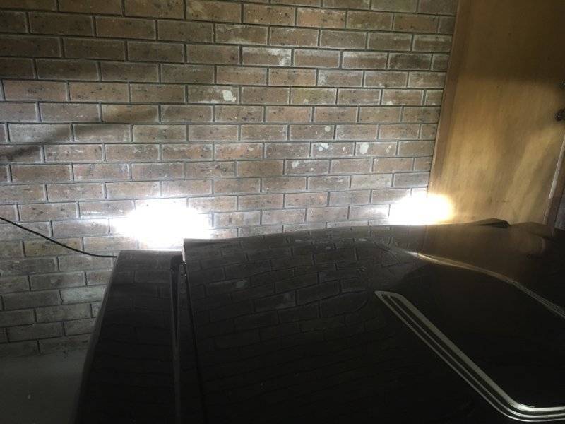

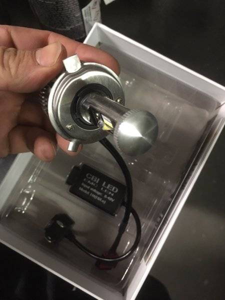

I got my LED globes last night, here's a few pics. They are better than the standard H4's I had, but in the garage the hi beams didn't seem all that much better, the Lows are definitely better however. This was also with out the car running, so straight off of the battery. These LED globes have fan's in them for cooling, which you could audibly hear, like tiny thermo fans. But you'll never hear them once the car is running. So I'm not concerned.
They do take a split second to kick in when first switched on, but after that they go on and off easily. There is also a slightly longer break between low and high as compared to the incandesent globes. All is acceptable for me, but if you are particularly picky, it might be a concern.
I'll need to use them on the street to get a true feel from them but happy enough for the moment. Easy swap and instantly reversible if I decide to go back. Not bad for $60aud really...
Globe specs:
Light Color 6000 - 6500K White
Lumens 36000LM/kit
LED Power 298W/Kit

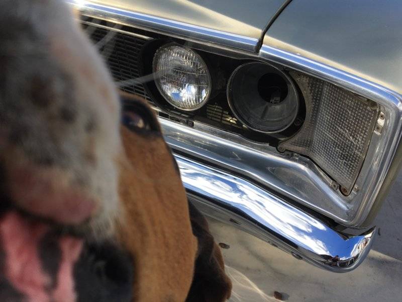

From reading other posts it sounds like you have the headlamps that can house HID bulbs. So I think you only need 2 kits of below (which is what i’m ordering):
https://www.theretrofitsource.com/hid-systems-20/hid-systems-universal/9003-h4-morimoto-elite.html
Taking a few quick measurements as we speak/forum post. I’ll do LEDs once I get the Hellcat Crate and Tremec Magnum in; still researching that.
