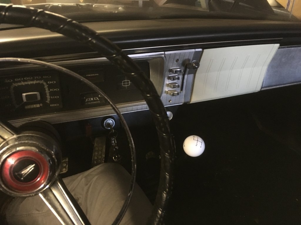

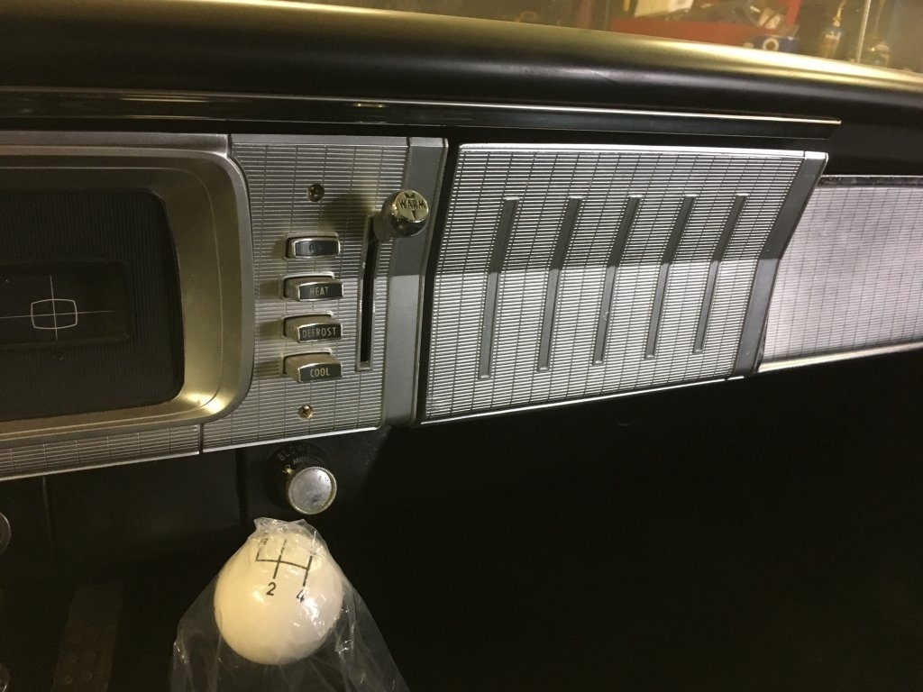

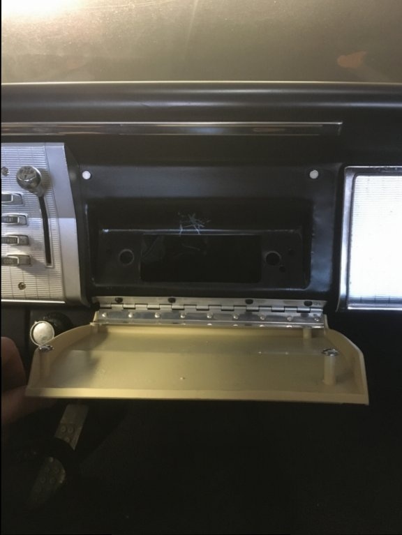

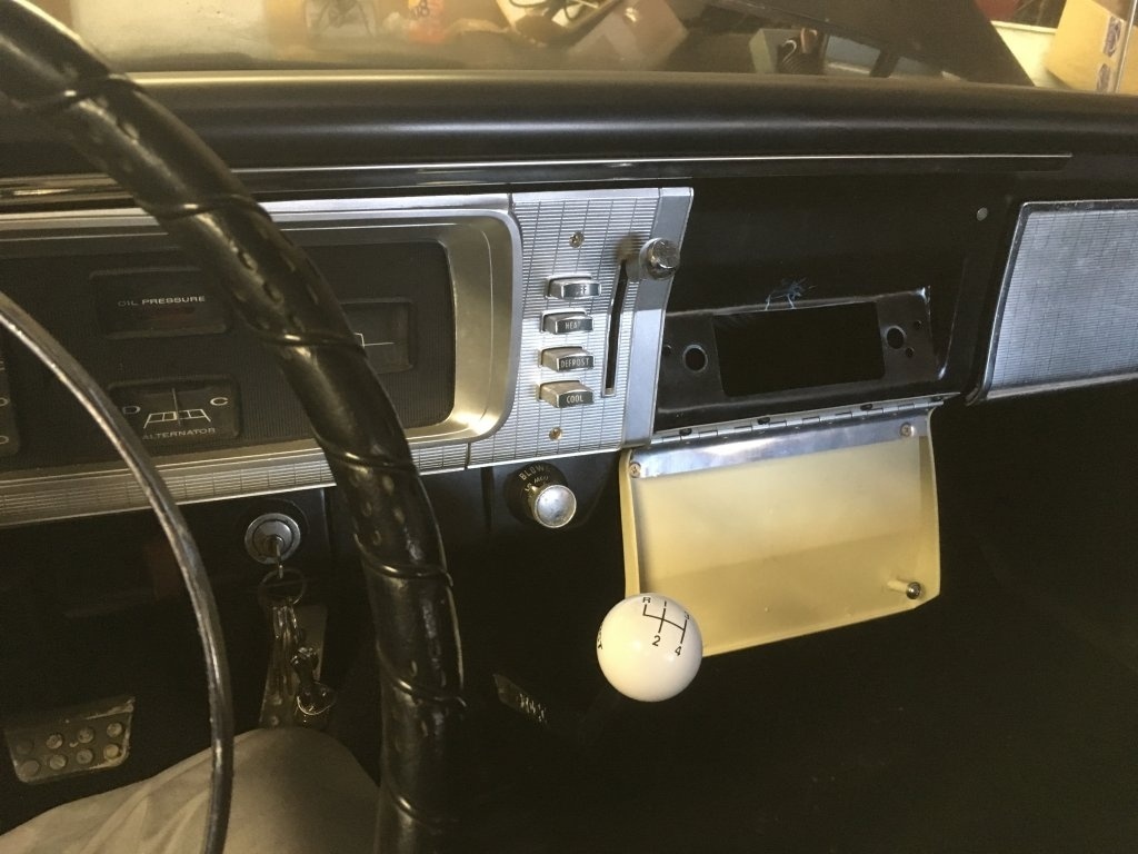

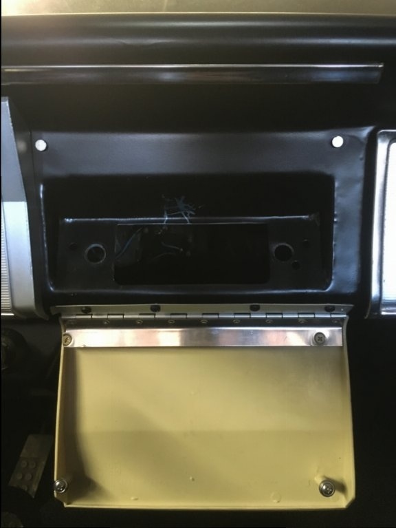

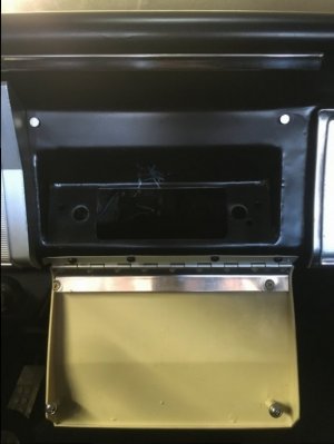

I was having trouble thinking of a cost effective way to replace my original AM radio in my 65 Plymouth belvedere II as there are only 1 or 2 AM radio stations in New Brunswick Canada and they are out of my way ....I can't stand the looks of a new radio in an old car and i don't like the look of a box or anything hanging down below the dash I figured I'd get creative without spending hundreds of dollars on a radio setup...I bought a radio delete plate from redvenomrepos (great quality and great customer service) and added a hinge mechanism along with magnets to hold the plate up....I now have the capability of hiding a new radio without it actually being seen I'll add more pics in a few weeks when I get the radio installled

Why not have your AM radio upgraded to FM/Bluetooth/ USB ? It will look totally factory on the outside, but perform like a modern unit ...http://www.ricksradioconversions.com/
With the dollar the way it is for me to do the cheapest upgrade which is 360$ US that's over 500$ Canadian which I'd rather put that money into the engine or drivetrain if I have to do far I have 80$ Canadian into this mod and the radio im putting in will have basically the same capabilities except I'll be paying less than 50$ for it
Good idea, I like that. May have to use that on my 64 Savoy. Thanks.

You'll not only hide the radio but you make it a bitch to turn on, tune, change volume and read the dial. May as well not have one there at all. I hope you don't intend on "distracted" driving just to use the radio. There are more options available in a radio like remote control. I bought a nice new Pioneer that sits up under the lower dash just above the console. It illuminates in a million colors to match the rest of the dash, has a remote and all the do-dads like USB, B-tooth, CD etc. Looks perfectly in place just like the old tape players jobbers used to install.
Cost? $182 at 2001 Audio/Video. Can adjust volume, bass, treble, input, brightness, channel, AM/FM, On/Off, illumination color source and song title off the remote which also has friendly touch dots for distracted driving. Hell, you can even put it under the seat because it doesn't use "line of sight" remote. You don't need to see the radio head because channels are stored in memory sequenssionaly - just push the up/down arrows on the remote. It's a good option that doesn't cost a fortune and will channel you cell through the speakers as soon as a call comes in. Even has an ultra mini microphone for hands free calling.
The radio I was looking at getting was a remote control one it takes seconds to flip the plate down and change that stuff and I rarely use the radio anyways it's more for the long ole drives with the girlfriend who can easily change that stuff as need be for the most part it'll have an aux cord or Bluetooth that'll rub off my iPod anyways and it controls volume and song choice anyways

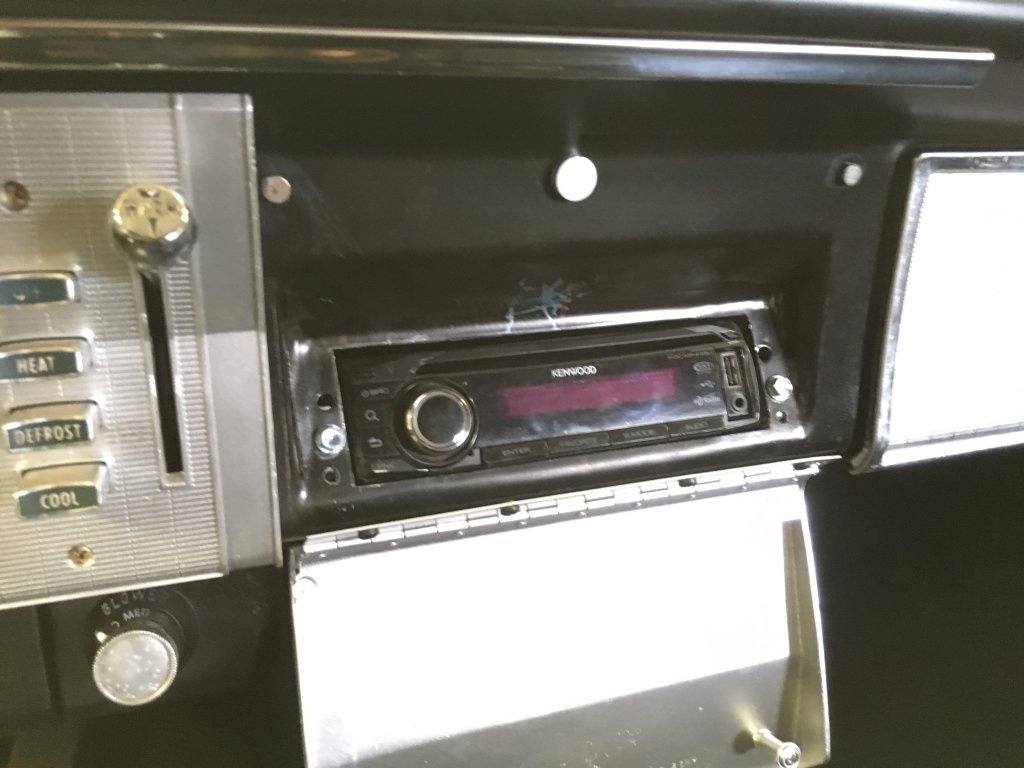

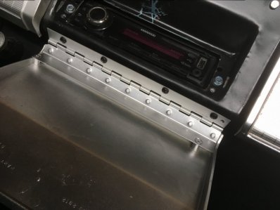

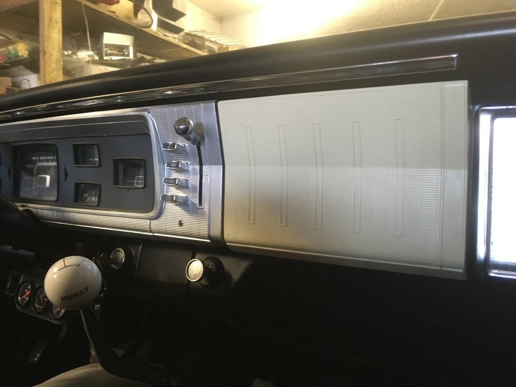

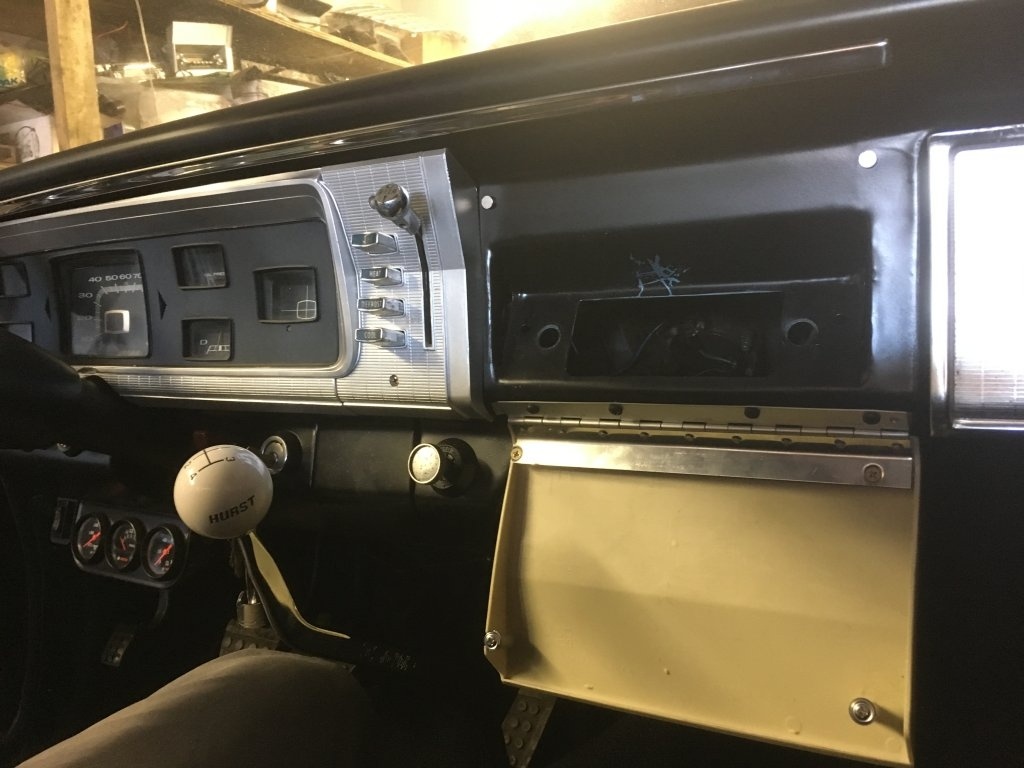

Finally got the hidden radio wired up and tested it works perfect and my remote for it works excellent so I don't even have to flip the plate down to change volume or stations even has an aux cord and USB port I can use if I wanna get really carried away

Cool idea. I don't have the original radio for my 65 Coronet, so this may be a good option to consider. I have an similar type head unit that I pulled out of my Olds Intrigue before I donated last December that I can use.

Wm, how did you attach the hinge to the faceplate? Epoxy? Thanks.
I used 2 course thread counter sunk screws in the normal screw location I just made the faceplate counter sunk as well as a plate I rivet to the hinge
Great job! I really like it the best of both worlds. Thanks for sharing.
