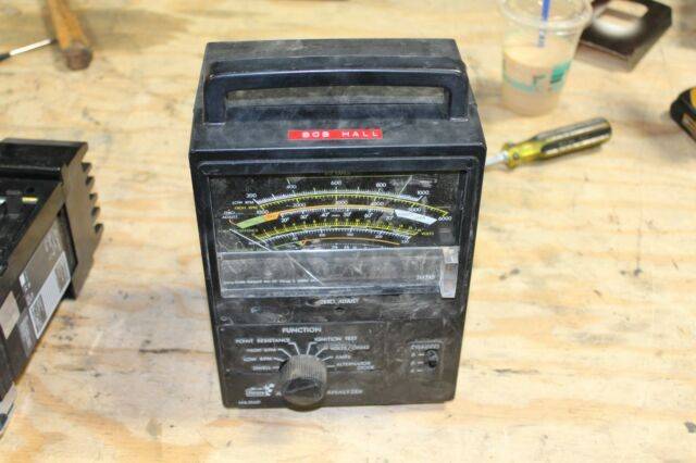

Was just about to mention that! My old Sears and Roebuck :D engine analyzer from the 70's is still pretty accurate.....

Well...... I have no idea about newer ignition systems....... I meant more like an “orange box” type of thing.
I don’t think they work...... well, I don’t think mine works...... with an MSD.
Seems like I used it on a drag car with a high performance Mopar ignition chrome box.....iirc. Dang, that was 36 years ago. The thing saw 7300 in the traps every pass! It had a mechanical tach drive set up and wanted to make sure it was reading right. My next car had an MSD but never even tried using the analyzer on it.
My tac/dwell meter doesn’t have a “power” lead.
There’s only two wires...... the one that goes to the coil “-“ and the other to ground.
There isn’t any standing voltage at the coil with an msd...... and I “think” that’s why mine doesn’t work with that type of ignition.
This is the one I have....only much cleaner!
https://www.ebay.com/p/1523031169
And got rid of the magnifier a long time ago.
