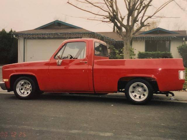

I used the PH30 in my Chevy for YEARS. I ran that 305 to 369,000 miles before it spun 3 rod bearings.
