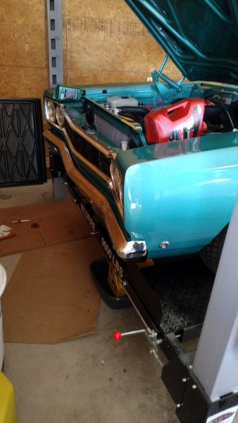

New 51515 wix filter and 5 new qts of Lucas hot rod 10-40 oil. Opened the door fired it up. Looking under the hood for leaky filter ect.
Lifters start ticking , WTF, zero pressure shut it right down.
I have never had to prime the filters on this engine.
It only sat 10 minutes with no oil in it.
Any of you guys ever get a bad wix filter or one that won't self prime ?
I'd love to screw the old wix filter back on and fire it but I'm chicken sht.
Gonna pull the distributor and check the pump drive.
Had one leak on me doing the Wife's 67 Forumla S.. but I have NEVER primed a filter or pump in my life.
This did happen to Dave with a Fram though in the past year or so..
Getting ready to head back out and pull the filter and see if there is oil in it.
