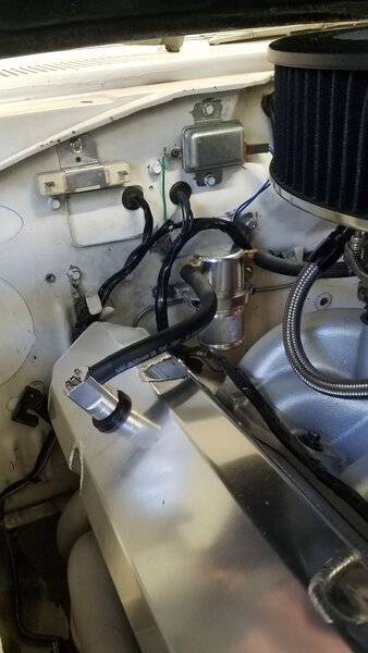

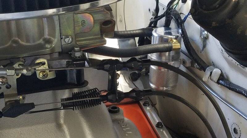

I posted earlier in the 'what did you do to your car today' thread that I installed a Moroso air-oil separator, in-line with my PCV.
Ouch yeah it was spendy. Probably too fancy for my roadkill-before-it-was-cool '68.

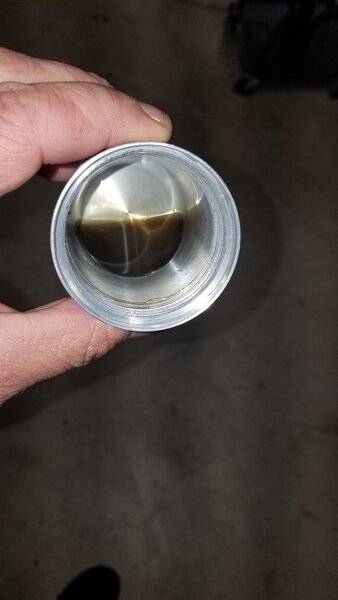

After seeing what it trapped after 3 drives, 27 total miles (One trip had several WOT blasts and a little spinny-spin for some kids at the gas station)---Damm!
I regret spending the cash not one bit.
I'm using Mancini's nice fabbed covers, and they ARE baffled....
Yikes! Almost a full tablespoon. And it was nasty; not anything you'd want going back into your engine--
.....Did I mention that's from less than 30 miles?! :mad:
Anyway. The Wagner PCV is tuned per instruction. Maybe a better-baffled cover would limit it, but it is what it is....I'm just glad that crap isn't going into my intake anymore.
Here's the unit, installed:

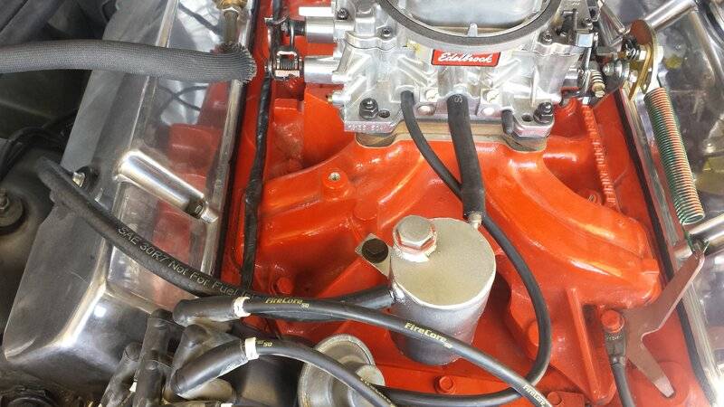

I'm using the Wagner PCV valve also. Using 440 source valve covers that look like yours but did not have baffles. I put my own baffle in. Don't have a catch can/separator, but don't notice anything in my throttle body either. You may be correct in having to readjust. I remember the instructions saying that it was a close adjustment but fine tuning may be necessary. My 496 stroker w hydraulic roller cam pulls 13" of vacuum at idle (850 rpm).

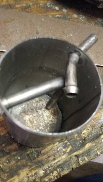

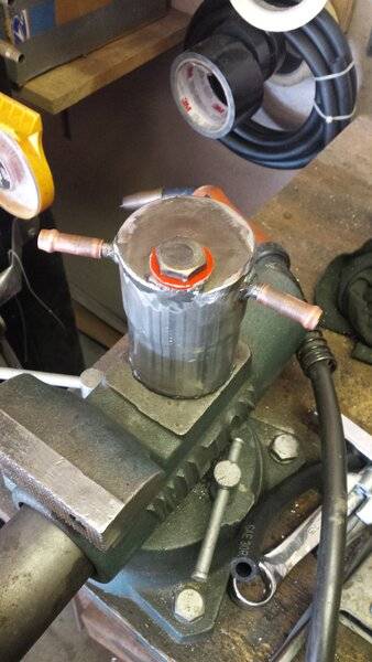

I built my own stuffed with stainless scrubber pads. Picked up oil but not a whole lot.
