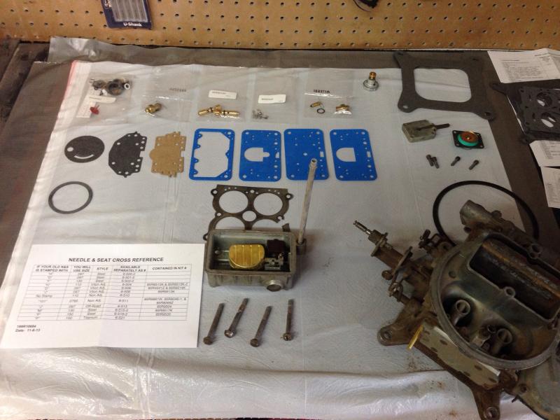

Here is how I laid it out

Thats the smart thing to do if you have not done any or many. Keep things like that and be very organized even as you take it apart. It will help you remember where and how parts went. Always good to be organized in all the work you do. Ron

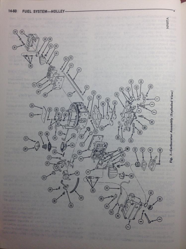

Thanks to you, I opened the book that I had two feet from my workbench,lol. The amount of detailed information in this book continues to suprise me.
