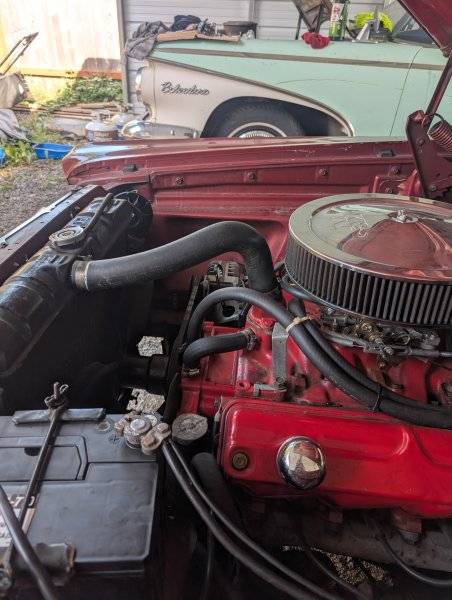

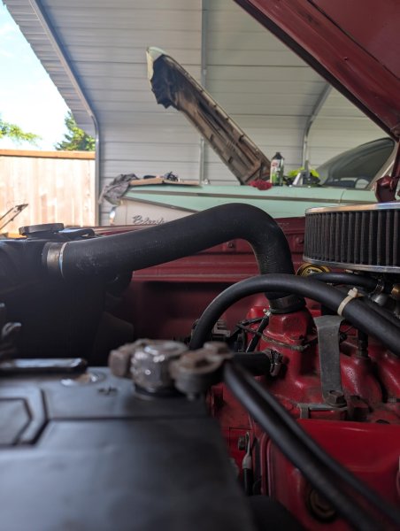

Haha yeah definitely not a race car or even a hotrod really. Just a cruiser with a little extra go. Yesterday when I got home I went out to see about the starting issue. I sat in and hit the key and she fired up like nothing happened.... I did NOTHING but bump the key. Not sure why the no start in the morning and no issue in the evening. Today fired right up so I took her to work. I plan on flushing the motor and radiator and replacing the thermostat tomorrow but today she comes with me. Lookin at the top hose and it's not bad, a little soft but I have a new one to replace it along with the lower. I've seen them routed above the top of the radiator like this before but I've always had it more level. Does it make a difference really? Thoughts....

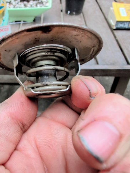

Think I've found the issue. 160 that never closes doesn't seem to be the way to go with this engine haha. I replaced it with a 180, flushed the everything and blew it out with air. I'm even waiting the recommended cure time with the RTV before fillin back up with coolant. In my youth as long as it was loud and fast (not like that stupid tv show) that's all that mattered. Now it's time to do things the right way so I really appreciate all the advice and support.

UPDATE: She's runnin fantastic in the correct heat range. Friday when I went to fill everything back up I went in and no start. She just cranked and cranked with nothin. No spark so chased that down to a bad condenser. Swapped it out and put a good set of points in while I was there. Did a little timing and at this point everything seems to be goin good. All the crankin kinda washed the plugs a bit. Took them all out and cleaned them up but will be swappin them out too this week. I did notice the 7-8 cylinders burn leaner then the fronts. I have yet to do a compression test so that may be my next move.
