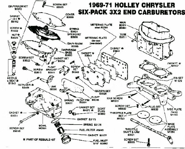

Does the Holley 4365-1 carb have jets or is it a metering plate? If it has jets where are they located?
Where do I find a diagram for the carb. Thanks
As far as I know this a 6 BBL carb as in list number 4365. Is this correct? The outboard carbs have metering plates and the main metering orifice is faces the bottom on the bowl. Just so you know those are stagger jetted as well. Not sure about a diagram but that metering system is pretty much the same as the secondary of any vac secondary Holley.

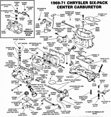

here's an exploded view
Hey, I caught that! Trying to sneak a Vette carb onto a MoPar forum :tongue:
yeah figured it might help anyway, it's what I had on-hand, but fuel inlet on the wrong side thou,
I didn't feel like looking for a different/Mopar specific photo...LOL...

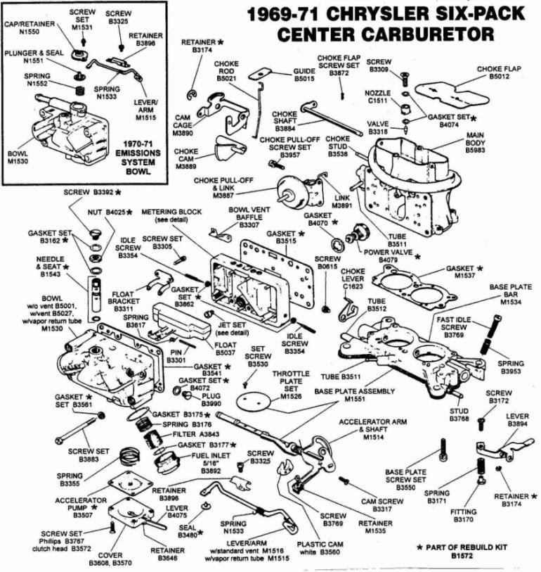

here's the allegedly correct ones, BUT if you notice, it still has the fuel inlet on the wrong side, just generic drawings, that one was from Promaxx
