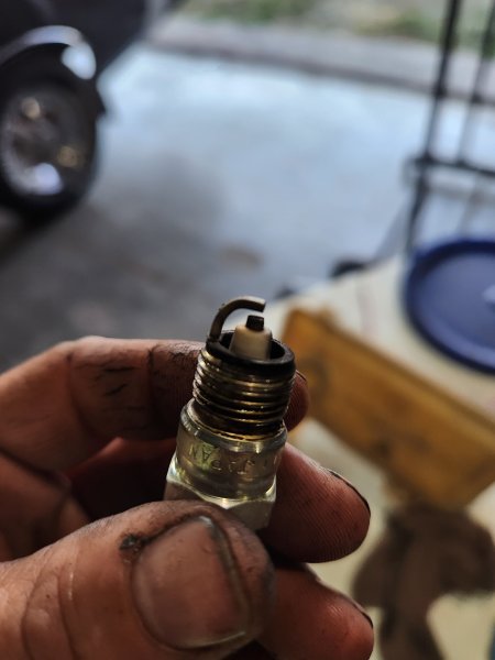

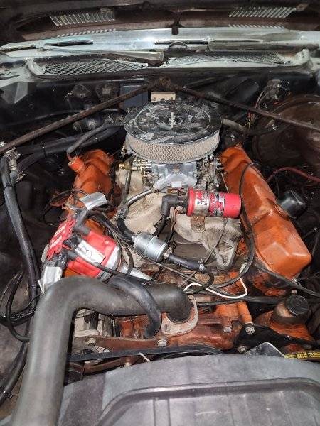

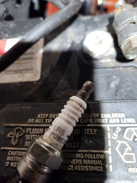

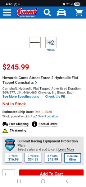

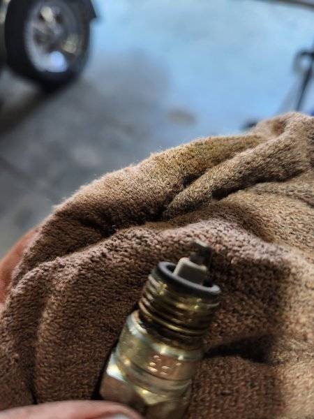

Got my 73 charger back on the road, 440 with a mild cam, edelbrock performer rpm intake, holley 750 vaccum secondary carb and msd distributor with a street fire ignition box, runs great up to about 3400 rpm and then starts breaking up, anything under that it runs good and if I mash it to get the secondarys to kick in it runs great also and doesn't break up one bit. Almost like it runs out of fuel at the upper rpm range, 72 main jets and 6.5 power valve, I have about 36 degrees of timing in it but need to check that again, it has motorhome 452 heads on it so using the ur5 ngk plugs, i really dont know where to go from here, this is the cam im using and some pictures
I would start by hooking up a fuel pressure gauge you can see while driving to rule out fuel delivery.

Kind of right,, leaking plug wires will show their true colors in a lean condition. So the lack of fuel is just that, and maybe the wires are marginal.. but could just be lean and miss firing. If there's enough current for the ignition at high rpm it rules out a lack of current theory
Check the dist cap & rotor for carbon tracking. This sounds electrical. Also, if the dist has a lot of miles AND has the vac adv hooked up, the p/up wires break from constant flexing. Measure p/up resistance should be 100-400 ohms, flex the wires while measuring.
As mentioned, may be fuel delivery. Empties the front bowl and when you go wot it starts draining the rear.
