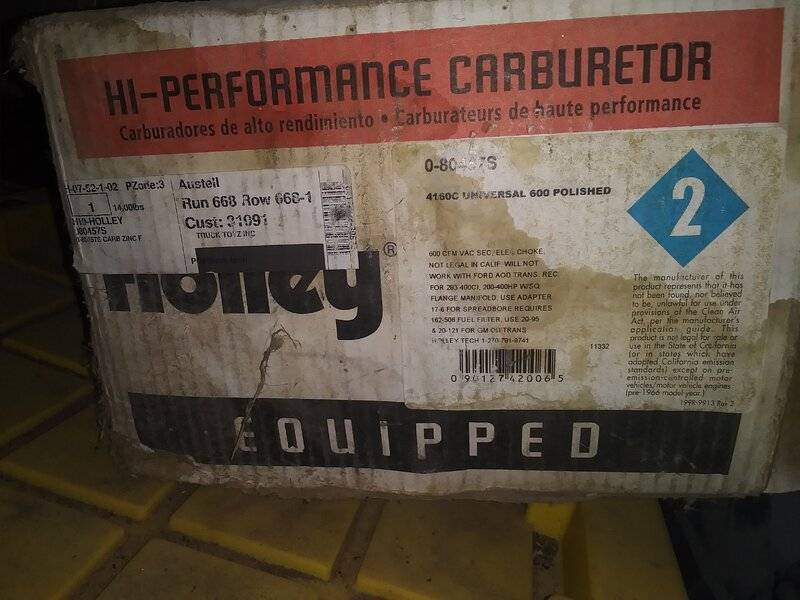

Post up the list number for the carb and the literature revision number.

Excuse the old and nasty box. I'll put a vaccum gauge to it and see what comes up

I did several times my friend lol I think I got it now. I did the normal reset and I got 20 on the vaccum gauge. The thing is it the carbs that are calibrated out of the box and its says not to touch the idle screws because they already set. I think it all good now just needed to do some research
I doubt any carb is set correctly right out of the box. They have them in a general ballpark setting so it'll work.
Every engine is different, with different needs and would require different settings on a carb.
