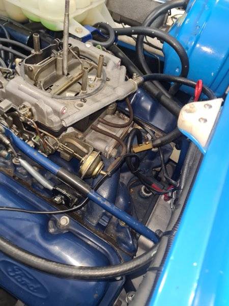

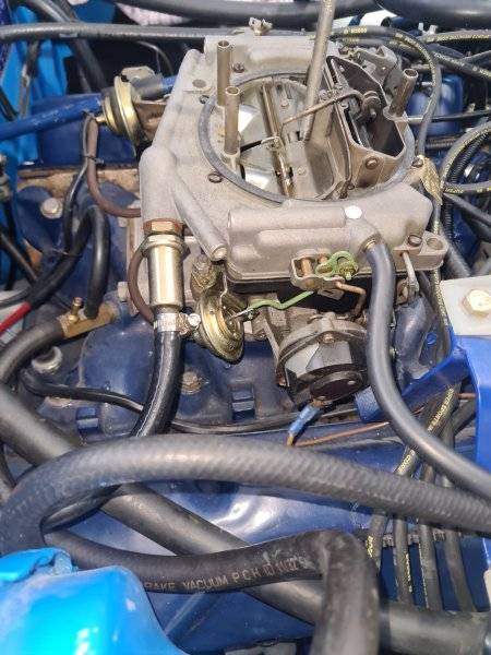

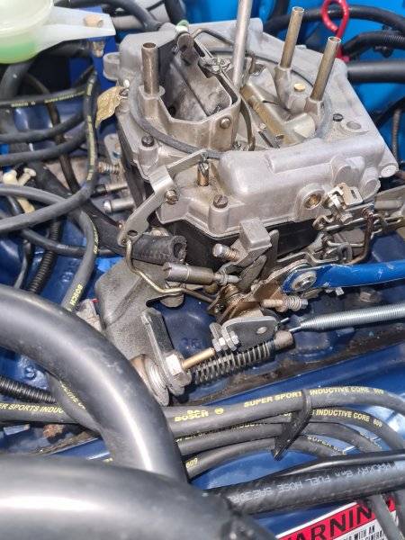

Hi all, I've got a TQ that has two vacuum pulloffs, the one on the side of the (electric in my case) choke setting and another on the other side where all the fast idle cam and rod are. It's fully restored and after adjusting air door, choke kick and other settings, is going beautifully but for one thing. I'm no expert but I am a mechanic and have been trying to understand how to get these great old carbs running right. I know how to engage the choke for cold starts and that works fine. After going to the floor with the accelerator, slowly release so the fast idle screw rests atop the fast idle cam. All good. But my fast idle screw always ends up right at the end of the first step, as in, the highest speed setting, just near the drop to the second step. I can't get it to end up coming to rest on the second step, just before the step up to the highest first step. Consequently, or maybe its for a different reason, if I set the fast idle to say, 1300 RPM (auto trans), it starts fine but the slightest touch of the throttle drops it down and stalling on a cold morning is a problem. What am I missing here? Cheers and thanks in advance to anyone who has some thoughts on it.

The rod connecting the cam is the usual adjustment point. Bend it to raise the screw up higher on the cam. A service manual would show the exact area to bend. I have never seen a TQ on a Ford or with 2 pull-offs. Of course I've never been to Australia!

Brilliant thanks Mike!!! I wondered if it was that rod as it is described in the manual as the one for adjusting the gap between the lower edge of the choke blade and the air horn wall. I'll take a look at the point of adjustment (usually an elbow in the rod) as described in the manual and have a play with it until I get the fast idle screw landing on that second step near where it transitions up to the highest first step. I'll post a reply so its here on the forum for anyone else who might come across this issue. Thanks again!! Dan

Update- Geoff, you were're absolutely right. I bent the rod for the fast idle cam and that allowed the cam to rotate a bit more so as to ensure the fast idle screw cam to rest at the edge of the second step just before it goes up to the highest first step. It was easy or and I actually found it easier to remove the rod and measure. I got it in the prefect spot after a few votes at it. All I had to do then was re-adjust the choke valve kick setting on the other side as it had moved as a result of that adjustment to the fast idle cam rod. Thanks again Geoff! Dan
