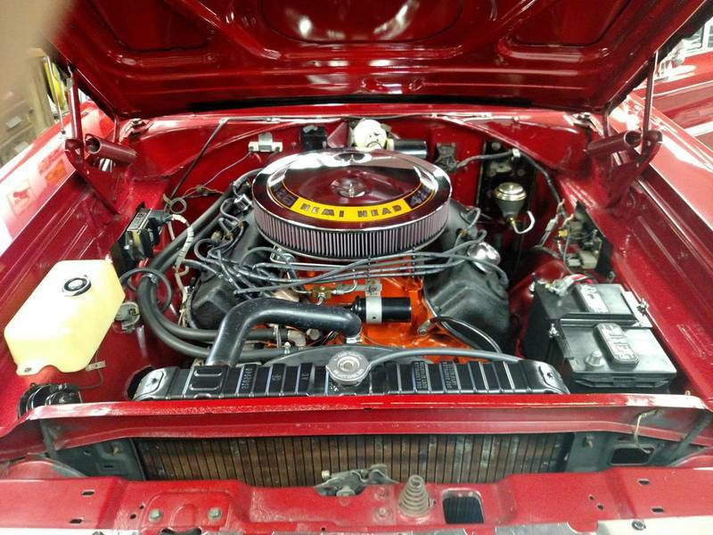

Engine color is wrong air cleaner and decal wrong. Engine color should be close to the decal orange. Seat belts I think are gold, I'd buy them if they were gold. Still mad at myself for not buying a NOS pair for $125, dumb dumb.
assuming it's true....... the owner waxed and maintained the paint, upgraded to electronic ignition, maybe freshened up the paint on the topside of the engine, and pretty much took very good care of his baby. It's a shame he didn't let it all deteriorate :fool:
are you saying factory enamel jobs have no orange peel? either that car has been apart or it hasn't, I'd say it hasn't
Factory enamel paint jobs had orange peel from the factory....PROVEN FACT!
Some key pictures are needed to see if it is original paint......One picture showing what appears to be an original trunk seal and the glue edge leads more towards original paint.
It is clearly single stage enamel and the orange peel looks factory correct. It also appears to me the body has not been apart.....
Date coded parts and glass will tell a lot also....
Far as the engine goes it has definitely been detailed and meddled with there are obvious things showing this.....
Carpet appears to be original but I am lost on the seat belts.....I believe the belts were replaced with a period set of the wrong color.....

since when did the grills get completely blacked out. I don't recall the 66 hemi air cleaner as an open element
The air cleaner has been modified and as you can see the grille was repainted wrong.
Needs some detailing under the hood, but not too bad. Obviously, the engine has been out & repainted the wrong color.

That orange peel is identical to my original paint '66 Coronet. One thing I noticed is that the exhaust tips are wrong - they don't come all the way out to the bumper originally.

Grille is right for a 440, IIRC. Rallyes are wrong. For being "all original", he's replaced quite a bit. Other things have been pointed out. I wouldn't be so picky if it hadn't made the "all original, unrestored" claims. It's very nice. Nowhere near $130K...half that, perhaps, like it is. Pictures underneath would be nice to see.
