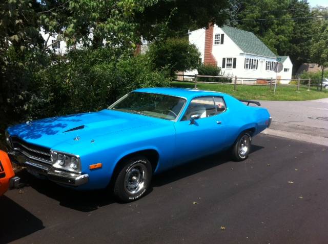

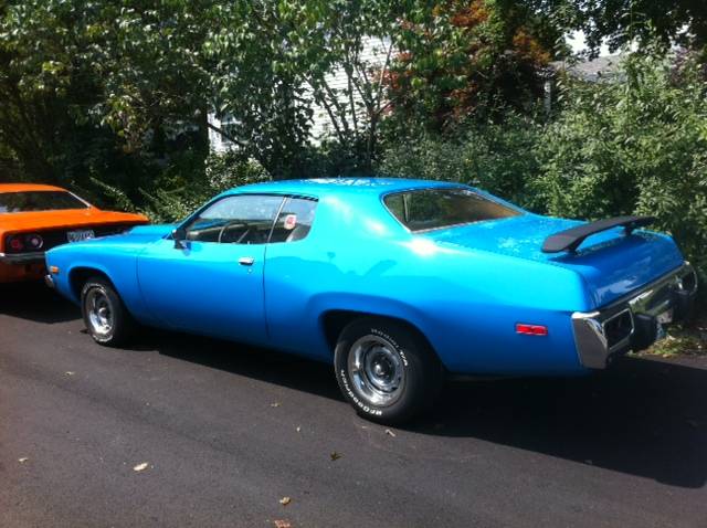

You should of seen the amount of headturns driving my Runner back from the shop yesterday!
How long does the paint need to cure before I install the stripes?
looking gooooooood !!!!!!!!!!!! :headbang::headbang:
why couldnt the stripes have been done a day or so after it was painted ?
oh by the way i looks great .

Looks good! It depends on what kind of paint was used. If it's urethane or what?

that thing came out BEAUTIFUL !!! id let that it bake in the sun for a week before i put the stripes on... but then again,,,im cautious...and **** retentive..... and retarded on occasion.

Thanks guys! My guy did a amazing job and loads of attention to detail when I get a chance I'll post pics of the jambs and valances
Without the stripes everyone thinks its a charger haha
