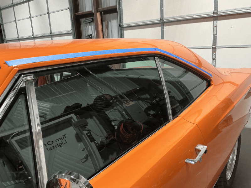

Would you please put a piece of tape on the car where these pieces are to be installed? I'm thinking they're different from what we're talking about. Blue masking tape lightly applied and then removed will help. Also a picture of the trim will help.
I do not want to put any tape on this beautiful paint job :). I will get a pic of the trim asap. Thank you.
Blast it,,, when I took off my chrome for painter, he said just leave that on. He taped that off. @beebest might help if he sees this post

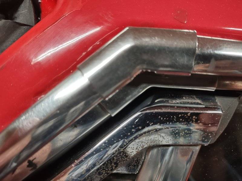

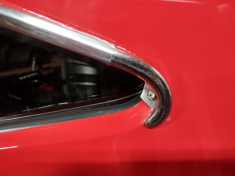

They can be a little tough to put on. I started with the windshield part of the drip rail, as it was the easiest piece to put on. Hook piece on the top of drip rail and pound on using base of your hand. Never use a mallet as you may damage the molding. Next was the hardest piece for me, until I figured it out, then not too bad. It was the J shaped piece on the end by quarter window. You will need to roll done the rear window. partially remove the rubber that window seals into and remove a couple of the trim screws holding stainless piece that rubber seats in. This will allow you to install the J piece as it has a tab that goes under the stainless piece that holds the rubber. It will go slightly under the long drip rail and also has a screw that will hold it in place. Now take like the long piece making sure the curve fits where you are about to install it, with end slightly over J piece, mine was about 1/16 to 1/8 of an inch. (Curve of drip rail will dictate this). Start the upper lip at J end and keep feeding the upper lip as you pound the lower lip on with the base of your hand. I had to slightly crimp end covering J piece to keep it on tight. The last piece was the small piece that covers the gap where windshield piece and side piece come together. Tape areas off that may get damaged during install or have a helper assist. There may be better, easier, or more correct way to do this, but that is how I did mine.
