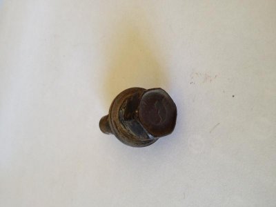

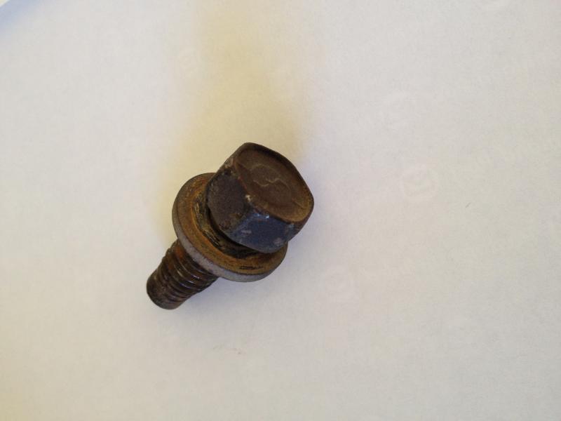

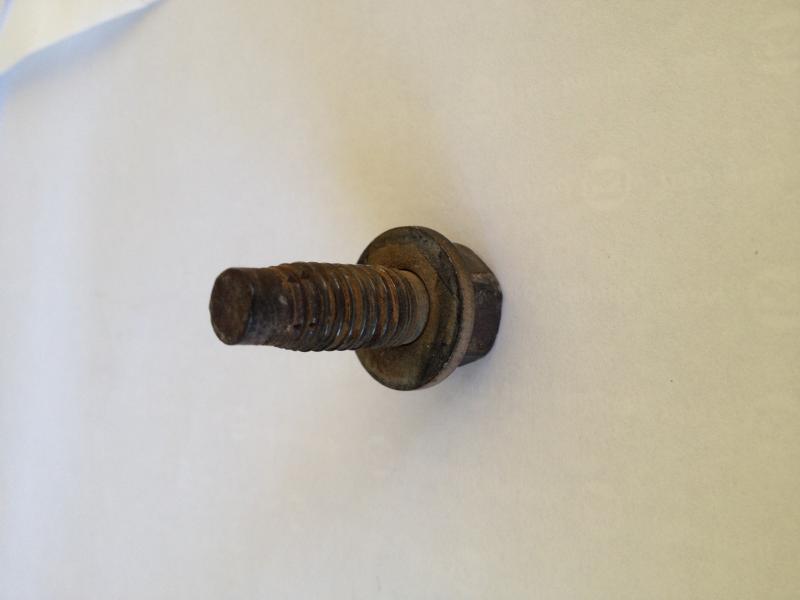

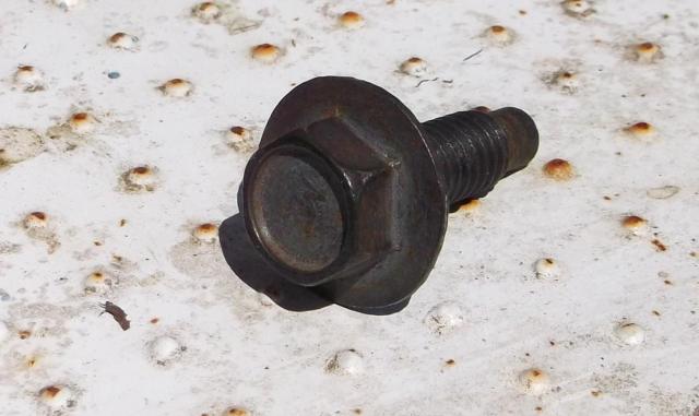

73 Charger Hinge to hood.
According to my research they should look like this.
3/8" x 16 - 1"
1" Washer O.D.
9/16" Hex Head
Anyone have (4)?
PM me please.

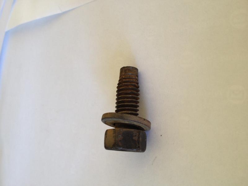

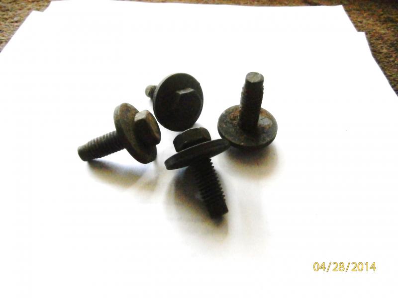

sent you an email....ones I found here are not exact like those.....solid head, thicker washer
I think the pointed threads are for U or J clips. The bolts shown with the unthreaded tip is for hoods with nut inserts. .................... MO
Hmm, interesting. The washer is a bit larger but I haven't had an opportunity to go out to see if it will interfere with the hood.
He mentioned those were door hinge bolts.

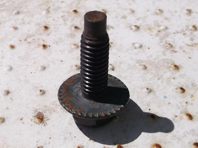

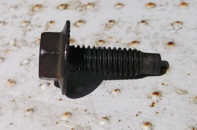

ODZKing, let me apologize for when I said mine looked like the one in the picture. I was going by memory, I knew the end was necked down and unthreaded. However, I just went out to take a look at my hood bolts, as the hood is off. Bear in mind that this is a 1970, I don't know if they were totally re-engineered a few years later. :) They have no separate washer, and there are ridges to help lock it in place, as these pictures show.
what size socket goes on those with the head & washer as one piece?

yea...hood to hinge would need 4...hinge to body would need 6....all of mine are 5/16" thread with 1/2" hex...I'm gonna say your 4 9/16" hinge to hood bolts are 3/8" thread with 9/16" heads is because that hood is so much bigger & heavier

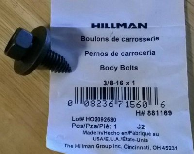

I got my new hood bolts at lowes in the bolt section look they have body bolts
Hey Bob,
Mine are 3/8 x 7/8 and the washer is a separate piece to the bolt. A 9/16 spanner fits the hex. I have no reason to suspect they have been swapped out as all of the hood to hinge and hinge to body are the same.
Yep, thanks to everyone. Lowes it is (was) $1.49 but hey, now I don't need to figure out what I'll do with 21 others.
Jase, I actually had a couple of those in my bolt bin, even with the "S" on them. But I've got these now.WP_20140503_17_15_32.jpg
