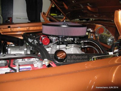

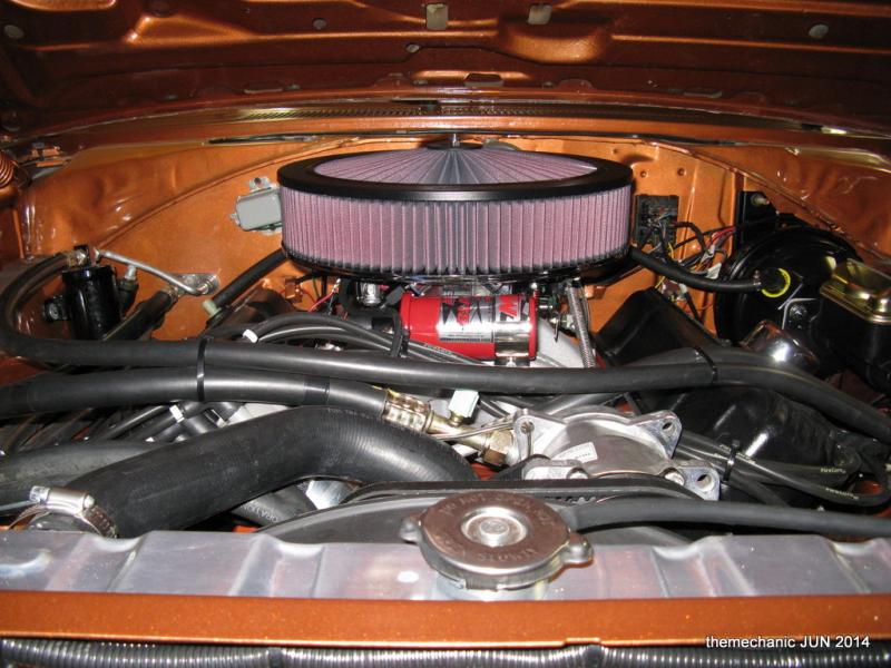

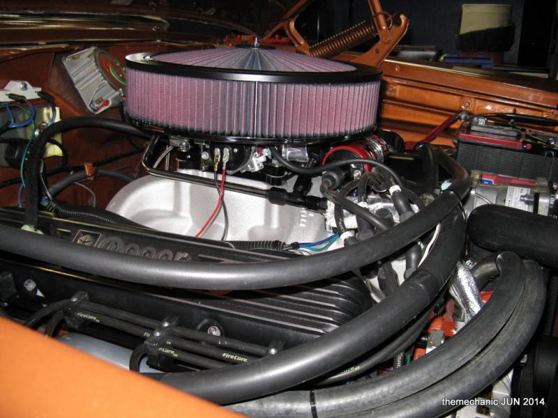

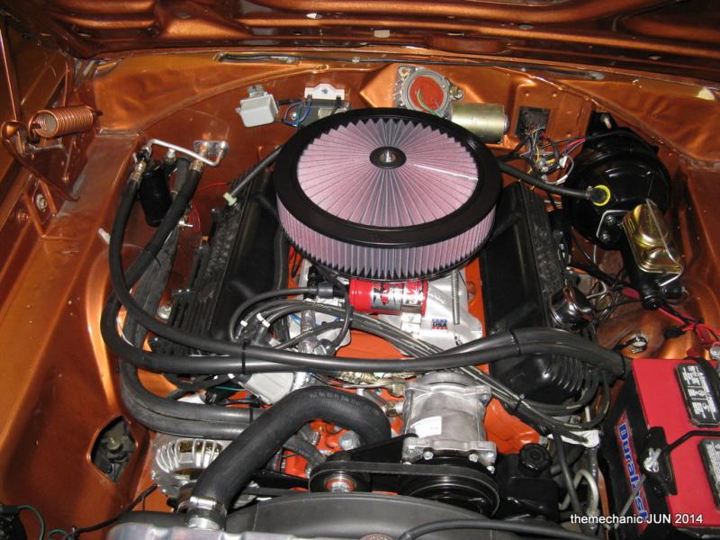

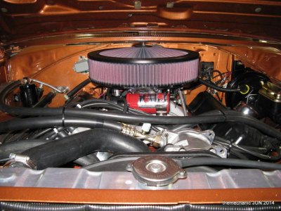

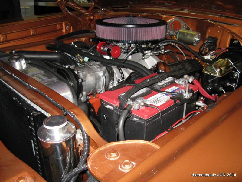

*****SOLVED 6-28-14*****
Edelbrock Performer RPM, Jegs 1/2" spacer, Holley Ultra Street Avenger 770, K&N 1 1/4" drop base plate (Part# 85-4535), 14" X 3" K&N filter (Part# E-1650), K&N X-Stream Filter Top (Part# 66-1401).
No air horn milling required. No hood clearance issues. I do not have a hood insulation pad.
Chargers must have a little less room than Coronets. That is the setup I wanted to use, but couldn't. If you put some dum-dum/putty on top of the carb stud and shut the hood, how much clearance do you have?
I have plenty of room above the air cleaner nut with the bulge hood. However, judging from the black paint rubbing off the back of the breather top in two places the hood is contacting just a bit. I guess I'll have to remove the 1/2" spacer.
