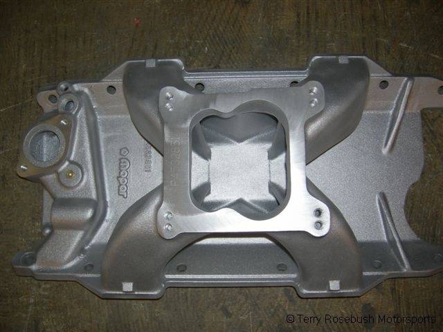

1970 Satellite with a MOPAR highrise manifold on top of a 340.
How tall of intake? Edelbrock air gap is a nice manifold for small blocks and fits under the hood easily with a drop base.
Its called an M1 not sure about the height.

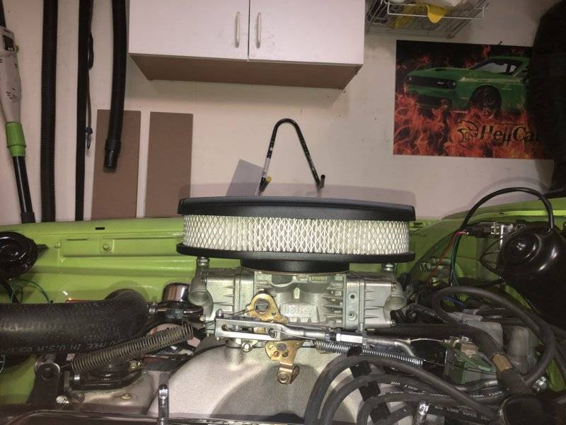

Yeah that air cleaner is just something I had from my old engine. But what type of drop base will clear all that linkage I am wondering.
I'm thinking even a standard OE cleaner assembly would clear the hood (and linkages), but could be wrong.

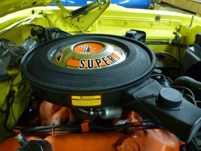

Auto store. Mine slight modifcation for choke, but the drop down gave enough clearance even with a 1/2 spacer. See if the guy at the store has one already open or will let you do a test fit.
Yeah, you need to get rid of that air cleaner assembly. Any of the standard 1.25" drop bases with a 2.5" or maybe even a 3" filter will work just fine. I like to use the K&N filtered tops with a drop base if you are not concerned with it looking original. Adds a bunch to the total airflow.
Yes, you do need a drop base air cleaner. You could also add K Frame spacers if more clearance is still needed.
