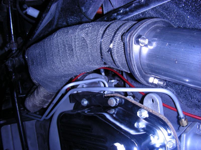

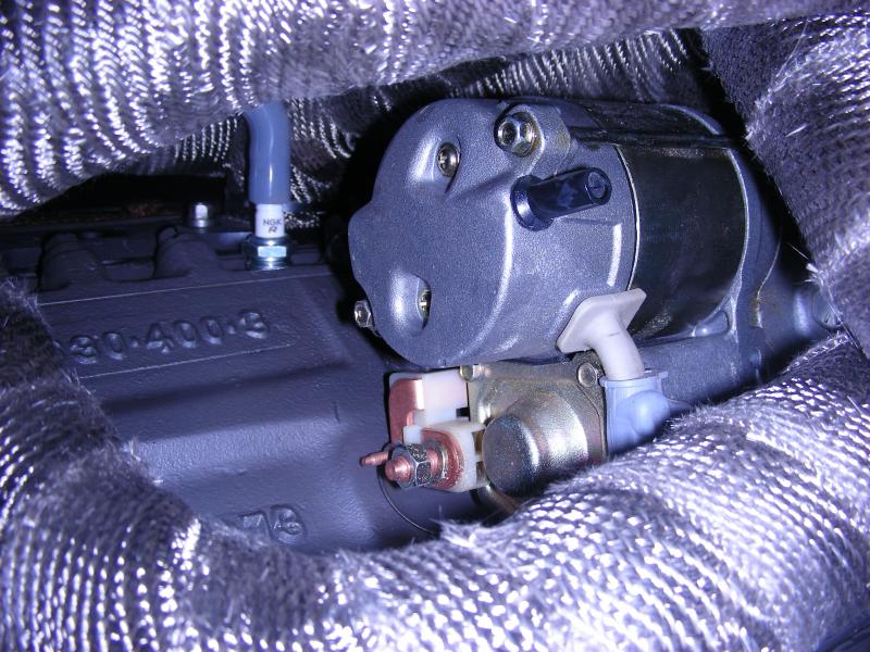

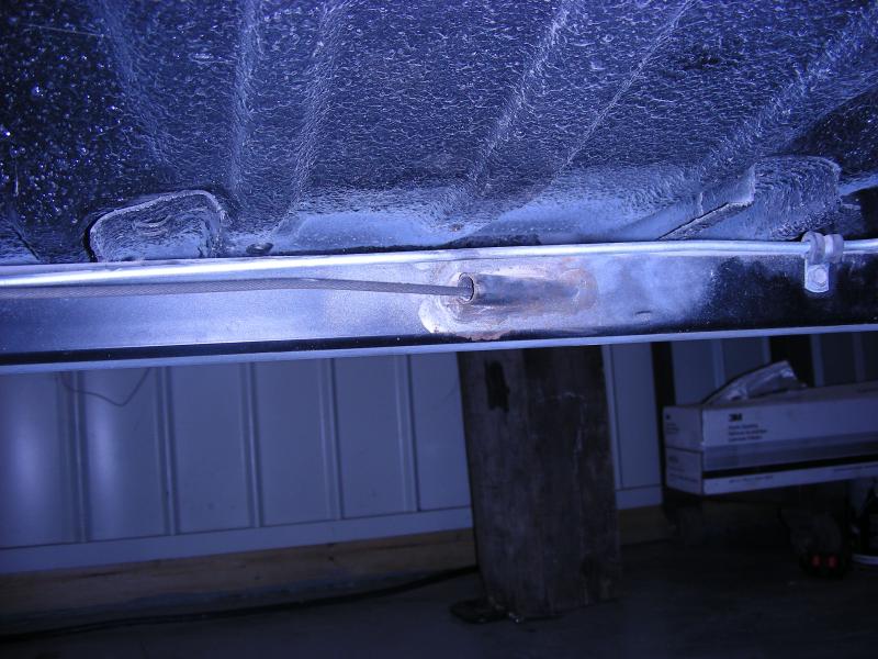

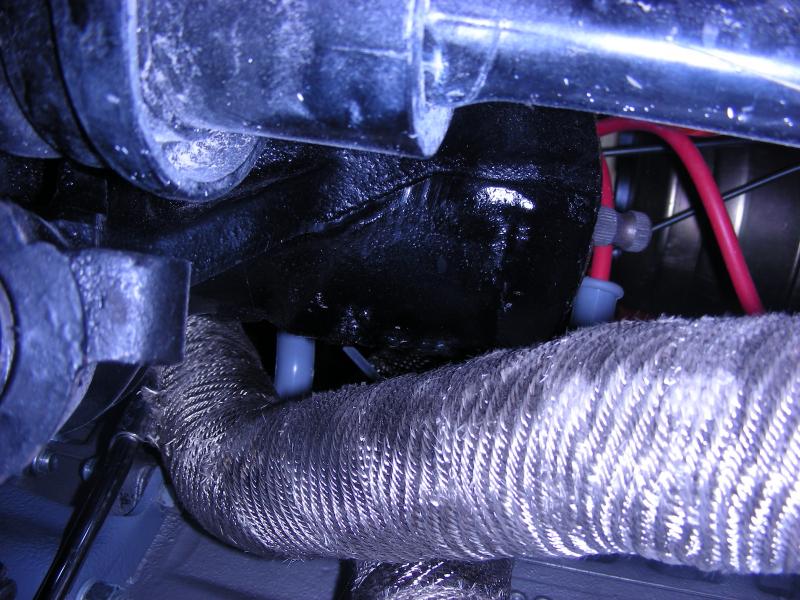

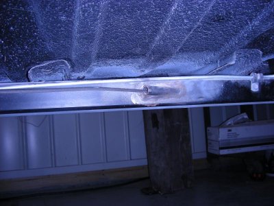

DSCN7621.jpgDSCN7626.jpgDSCN7630.jpgHear is a few pics. Like I said I have zero problems north of the collectors, all issues are where the pipes come together and dump out. You can see how the driver side is curved now, I thought that would be better then tight bends in the exhaust in order to dodge the crossmember. As you can see the starter has plenty of room (it's a mini) and although hard to see in the pic the steering box is fine as well. Before anyone says anything the trans lines aren't as close as they look in the pics, I might still install a heat shield.

View attachment 99173View attachment 99175View attachment 99176Hear is a few pics. Like I said I have zero problems north of the collectors, all issues are where the pipes come together and dump out. You can see how the driver side is curved now, I thought that would be better then tight bends in the exhaust in order to dodge the crossmember. As you can see the starter has plenty of room (it's a mini) and although hard to see in the pic the steering box is fine as well. Before anyone says anything the trans lines aren't as close as they look in the pics, I might still install a heat shield.
