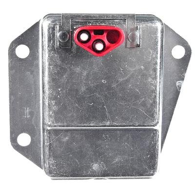

I'm in the process of making this switch on my 67 Coronet. I bought this: http://www.oreillyauto.com/site/c/d...ulator_1496007_3319&keyword=voltage+regulator . It's cheap, works, and semi close to oem looks. I painted mine black and found a company online that would restamp it. Here's a pic of mine.

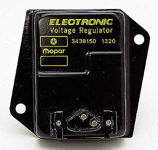

I got the MP voltage regulator from Jegs. I originally tried a repro, date stamped one from YO, and didn't work, brand new and it was faulty. No issue with the Jegs MP regulator.

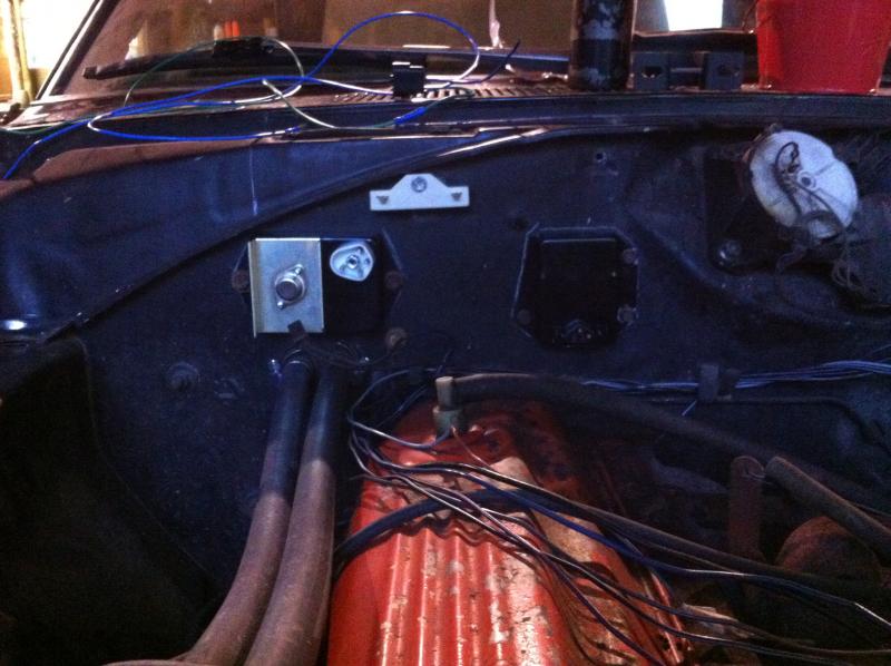

Here's the one I installed, I updated my 69's electrical system as you are doing. Also had to switch to the 2 field alternator.
If you have a dual field alt you need the regulator Rebel posted. On my '66 with a single field I run the Mopar Performance 3690732.

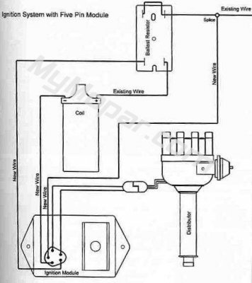

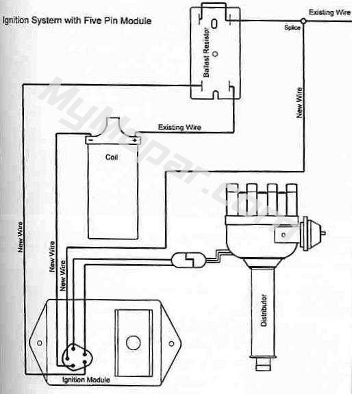

I run the CEI MP Chrome Box for the street with a MSD Blaster 2 coil & CEI Adj. vacuum adv. distributor{different springs for different advance rate & vac. adv. adjuster screw all the way in with a total of 35*-36* degrees BTDC} with a 73 & later style Chrysler 4 pin ballast & wiring thru a dual field 75 amp Powermaster Chrome alternator & Chrysler electronic regulator...
