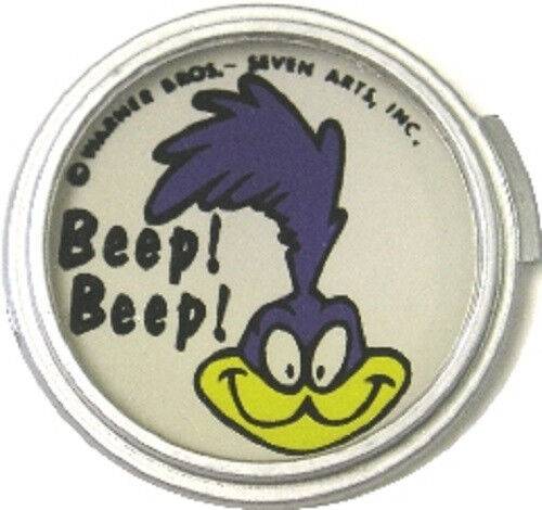

I know it should be simple but. I have the three spoke wheel with 1/2 to 2/3 circle horn on my 69 RR. Do you not push in and turn counter clockwise on whole assembly to remove it? I can turn it about 10 degrees but it won’t release. Afraid to muscle it too much as I can see plastic lugs breaking off or something like that. FSM only shows regular satellite horn button.
Carefully pop out the Bird in the center. There is a locating tab on it. be careful. Pry out near the "BEEP BEEP" Then take out the bolt under neath and there are three Phillips screw in the horn button,,,,,
I was about to try that but figured I’d better ask before I break it. Thanks for the instructions.
Got it off
