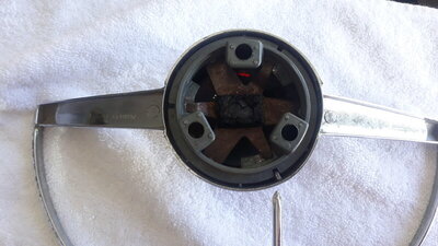

How the heck do you remove the chrome horn ring on a 1966 B body with the color plastic wheel
On mine the center cap is part of the ring.
Ive twisted and pull and pushed to no avail.
Im afraid im gonna break something
The ring is real loose and flopped to one side. ( horn blows by itself at the most interesting times )
So was hoping to get it fixed today
Ok.
Got it off

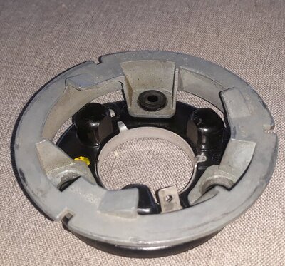

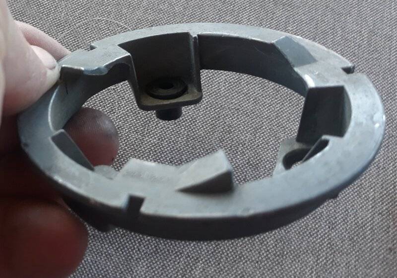

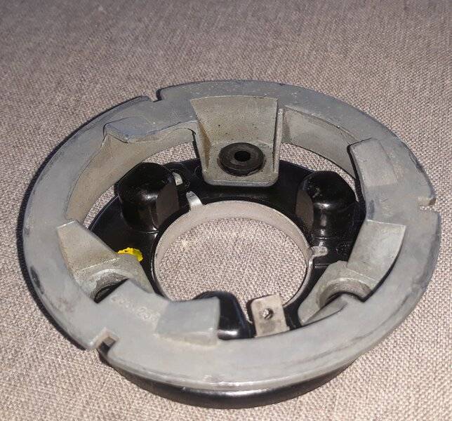

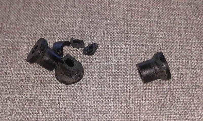

I need the small black plastic spacers that holds the cast lock ring to the horn switch.
2 out of the 3 are broken
Ps.
To get the chrome ring off requires lift it slightly then twist counter clockwise.
There is a lock tab to overcome on the back side that snaps into a grove
