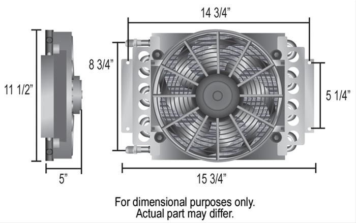

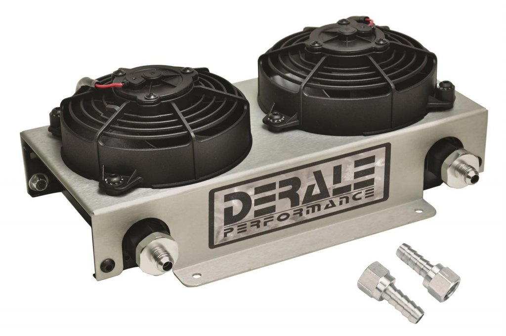

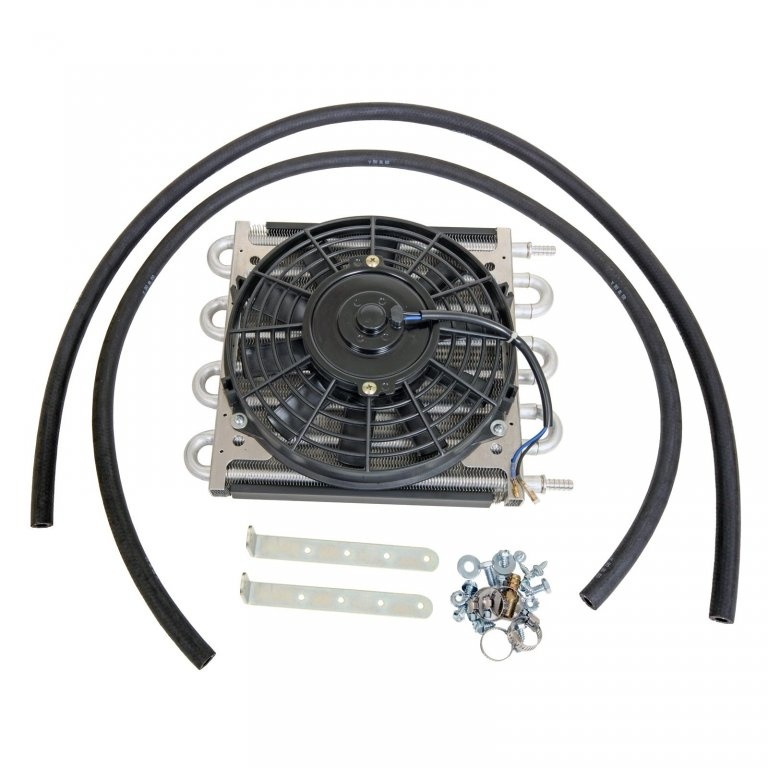

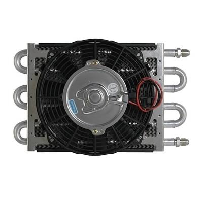

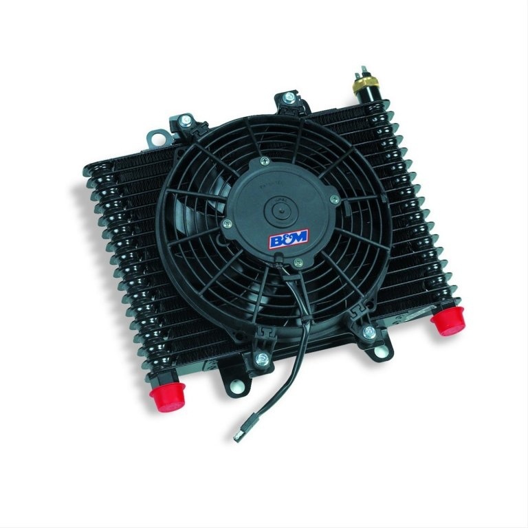

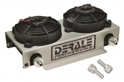

There's a few that are great from $140 or so to $300
depends on your needs, fitting & hose types etc. & likes
or the actual locations &/or room available
Derale, Perma-cool, B&M I've used all 3 with really good results
make sure to run/use a relay & off/on arming switch just because too
it'll help you trans/converters live longer too
Transmission Derale Electricool Trans Cooler & cooler Dual fan assist.jpg Transmission Derale Electricool Trans Cooler & cooler fan assist der-13700_w dimensions.jpg Transmission B&M Super Cooler Trans Cooler Fan Assist bmm-70297_xl.jpg Transmission Perma-Cool Maxi-Cool Trans cooler wit fan assist prm-13211_w.jpg Transmission Summit Racing Trans Cooler with fan assist sum-331200_sn_xl.jpg
