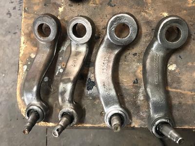

The Fast Ratio stuff is about 1" longer, you can see the difference in the picture below. The far right Pitman is a Fast Ratio unit.
Knowing this.....you can then look at the clearance you have right now where the center link moves, the idler and Pitman too. If you are more than 1 inch from the exhaust, you should clear just fine.
I've found that the change to these loner arms changes the toe setting about 3/16" OUT. I was 1/8" IN before and just shy of 1/8" out afterwards. You can rotate the tie rod sleeves yourself to correct it. One turn on each should give you about 3/16" Be sure to check and confirm this before locking down the sleeves and driving very far.
